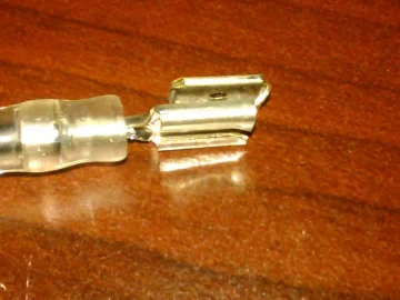

the clips on the reciever do not fit into the back of the stove. they have this little extra piece of metal, see picture and sorry, I don't no the correct terms for these parts....
can i cut them off? if i cut them off, they will look like the clips on the lux thermostat that came with the stove.

It won't hurt to cut the extra piece off.
You can remove those wires from the reciever by turning out the screws and use simple thermostat wire instead......or you can cut those connectors and strip the shielding.
I used different wire just in case there was an issue with the Skytech working. That way it could be returned.
