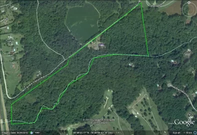

    I guess I am OK on the carbon neutral front ;-) I have 44 acres, I can harvest 10 to 20 cords/year according to my forest management plan (long term sustainable), and if I run short, I'll ask the golf course if I can manage the north part of their forest too!. I do use a tractor to harvest the wood and a gas splitter and chain saw, but our house is 100% wind power through the utility (Clean Currents). Maybe I do need that draft horse. [My property is inside the green lines]
      File size:
      148 KB
      Views:
      347
  24. jharkin
    jharkin
    Minister of Fire 2.
    NULL
    Oct 21, 2009
    3,840
    1,300
    Loc:
    Holliston, MA USA
    Yup.
    And your own sweat equity swinging that axe is powered by the food you eat that is grown from FF based fertilizers and harvested with FF machinery.
    S*(*&^ no matter what we do.
