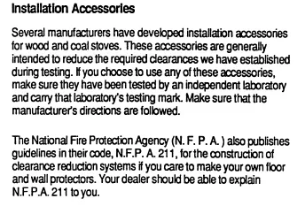

    The maual says that different manufacturers produce accessories that will alow reduced clearances that the testing jotul has put forth in the manual and that there are also N.F.P.A.211 code to consider if you wish to build your own wall and floor protection. so... They dont say i cant, and dont say i can....

    I'm no lawyer but the first sentence tells me that it is okay.

    Looks like a call to Jotul may be in order. Maybe they can give you a definate answer regarding the supplementary heat shield. I would think you should be fine, that is what those supplementary shields are for......but you wanna cover all the bases prior to commiting to the project.

    It seems that the 43x38 minimun pad size assumes that the pad will sit 9" away from the wall. If you want the pad all the way against the wall by the manual The pad will have to be 52x38, but the actual stove front will only be at 34" from the wall (if my math is correct the stove is 17" deep?) . So by building an air gap you want to reduce the rear clearance to 9". I doubt that you'd get buy off from Jotul to do that. Mainly because they have know way to know what your construction will consist of and no way to test it. Manufacturers only have the ability to test their product against a standard install. It would be near impossible to test every install scenario that people come up with and I doubt they would assume the liability that your construction is done right. I would post some pics of the install area and see if anyone has any ideas. One may be that the pad is built flush with the floor to prevent a trip hazard. and that would provide the proper clearances and still have the stove front at 34" away from the wall. Manual states that the floor protection must be 3/8 non-combustable mill board so the floor could be cut out to accomodate that.
