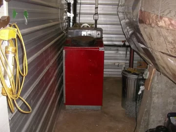

    The Jetstream boiler was built pre EPA regulations and still exceeds these requirements! It was one of the first commercially built gasification wood boilers and can likely match many of its modern counterparts in performance. Its production was very short lived. From 1981-1983 and only around 900 or so units were produced.
    What I would like to find out is how many may still be in use? Do you still operate one, have a spare, know of one in use, sent yours to the scrap pile or have used one.

    That looks like a nice compact unit. What is the btu output?

    120,000 btu gross and on 5 hour plus burn nets 100,000 -105,000 to storage.

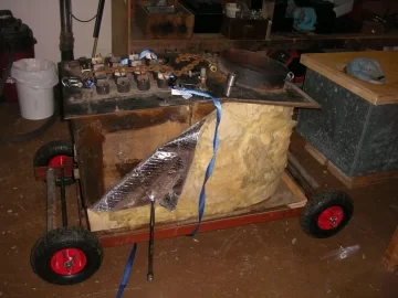

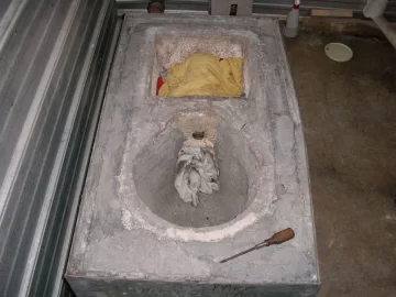

    Pictures a new refractory liner , and a complete base liner installed.

    It's great that you are keeping this baby in good condition. Where did you find a refractory liner?

    I too am wondering if you bought or cast this liner yourself. Did this slip in the old ceramic outside or did you then pour the outside to the steel frame? It looks like there is a lot of expensive ceramic in this boiler, Randy

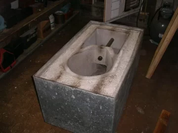

    Allan, Nice job on the new base!!

    The refractory liner was purchased from Kerr controls in Feb. 2011. Kerr at that time, said they had one more but were still making clean out plugs and tunnels. I have made molds to make my own refractory tunnels and clean out plugs .
    The refractory base was what made the boiler so clean burning and efficient but its expense was likely its undoing.

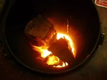

    Since joining Hearth.com a short while ago, I have learned that its modern counterparts work on a much different principal. The Jetstream was designed to burn clean through the entire burn cycle.
    The modern down draft units appear more to cook the wood then burn the smoke as it passes through the coal bed into the refractory nozzle.
    The Jetstream at about hour 3 of a burn, the base really starts to transfer heat into the heat exchanger above, almost like a kettle on top of a hot stove. An example of this heat transfer - after the fire is out, the circulator runs for another 3-4 hours taking the bottom of 1000 gallon storage from 165-170 F to 175- 180 F..
    Picture is of the heat exchange showing the loading chamber and heat exchange tubes.

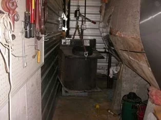

    The liner I bought from Kerr Controls. The fill between the liner and the metal frame is poured with vermiculite. I had considered making a mold and a new liner but the 800-900 lbs of refractory cement was going to be about $1500, so I purchased the new liner as it is a proven product.
    Over the boiler, I have an overhead track so with the old liner and vermiculite removed, the new liner could have been lowered into place and the vermiculite replaced between the liner and box.
    Pictured is the heat exchanger being moved back to the base following repair to the original liner.
    The repair to the original liner I did in September of this year and so far, it has been a success with no cracks.

    I would like to take credit for the job on the new base. This is the base to unit 0175, a Hampton Technologies Jetstream that I purchased in October off of eBay. The boiler was still on its original shipping pallet.
