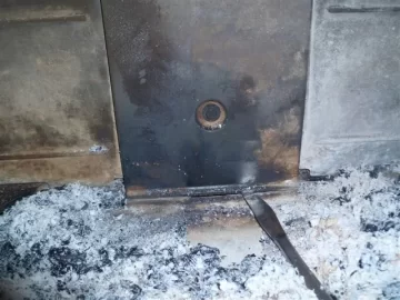

    What i did notice however was a 1/16" gap between and along the bottom of the airduct (held with one bolt in the center against the inside back panel) were it meets the bottom of the fire box.
    This gap will allow air to enter in the bottom of the firebox close to the main air inlet. I don't know if this is designed this way or maybe cement once filled this gap but if there was there is no trace of it left.

    I was rereading the thread and just caught this. Can you post a picture of this part? If this is the air slider, it's essential. Maybe the reason it wouldn't burn well originally was the wood? I'd definitely put that plate back in and try it. Post pictures so that we can see what you are seeing!

    OK, isa tupid ,..my yotul is a model 600,..not a 500 as i originally posted.
    The 600 has no firebricks but cast iron inserts.
    Here is a pic of the airduct cover,..tell me if this gap(knife inserted) is normal or needs cemented closed.
    you can see on the bottom were the incoming airstream kept the floor clean of ashes in front of the duct.
    Neumsky, i did not remove the main air control,.just the sheetmetal plate with the 1/4" drilled hole in it that covered the main control
    That little hole controlled the max airflow allowed to enter the firebox trough the doghouse orifices regardless of the setting of the control lever.

    That gap should be sealed be in my opinion, but doesn't explain the issues you are having. That gap would only allow secondary air to enter the firebox prematuraly. Clean the area real good and re-seal with stove cement just to make sure. Now, whats up with the part that was removed? I have tinkered with several Jotuls and I can't picture this part that you are talking about. Do you still have it? Can you post a picture of it? I think re-installing this part would be the first thing to do.

    if that gap is supposed to be cemented closed it can very well explain the problem i'm having.
    If secondary air dat is meant to come only trough the top has a change to feed trough that gap in the bottom.IMO it'll have the same effect as leaving the ash door a crack open.
    There is nothing better to get and keep a fire roaring uncontrolled than to feed it continuesly air from the bottom.

    I changed the title to Jotul 600. I am not familiar with this air restriction plate, can you post a picture of it? For sure I would put it back in. And go ahead and force a little stove cement into that gap.

    Like I said, go ahead and seal it, just to make sure. It would only take a few minutes to solve the problem. Maybe using the ashpan door to get a fire going caused the problem. This causes isolated parts of the stove to over heat, and should never be done according to the owners manual.
