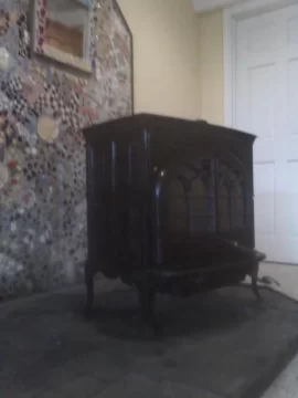

    I am going to be looking at a Jotul F12. Can anyone give me any advice on what to look for? For instance, how can I check the cat.
    The lady said she used it about 40 times total and it was bought new in 1997.
    She did disclose that one of the door glasses has a small crack in the corner. Where can I source new glass for it?

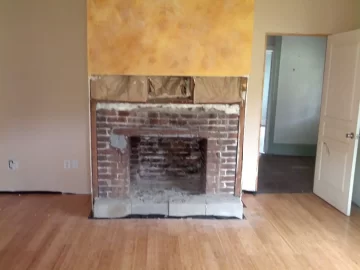

    I looked at the manual for the unit and it says it's 27.5" center for rear exhaust, and my existing opening is 26", so the duct would swoop down before entering the existing masonry chimney.
    I will be building out the hearth to accommodate the stove, although I didn't see any clearance measurements in the stove manual for the bottom.

    You should do a thorough inspection take a light and look for cracks. Ask why the glass is broken it may have been run very hot and over fired. I am not to knowledgable about cat stoves. There are a lot of cat stove users here though ! It is possible that it was only run 40 times but why would be my question. Keep in mind that a 400 dollar stove may be good but if you have to put 400 more into repairs it is worth buying a new one.

    Sounds like your rear flue exit height won't work. You don't want to swoop down, you want a slight rise up or you will have smoke and draft issues. You may be able to move that fireplace lintel up a bit?

    Yeah, that's definitely a possibility. I was also thinking I could use a different hearth arrangement, instead of those pancakes, to get a little more height.

    Short leg kit to drop it a little?
    Is that stove Blue/Black enamel?

    Absolutely right. Smoke will not go downhill. It will seek another exit, which is typically the front door of the stove when you open it. Looks like you have a serious amount of work to do on the hearth so I would get rid of those big cement blocks and put in a lower hearth that extends out further to accommodate the stove.

    The room is about 18x18, and adjoins the dining room and kitchen and is very open. The 3 bedrooms are on the other side of the house with a front to back hallway splitting the 2 sides (almost a square with a hallway down the middle). There is a door in the kitchen and living room which both enter the hallway.
    I have been mulling it over and will definitely take out the cement blocks to get more height, regardless of the stove I end up with. Any suggestions or threads to read on hearth materials? I was thinking maybe sheet metal underlayment with hardibacker and slate over? Is that close to acceptable for a stove with legs like the f12?

    Each stove has specific hearth requirements. Find those requirements and then do a search on hearth building. You should see some decent results.

    I would lean toward a bit of overkill on the hearth. That way you are better prepared for any option. By using micore under a couple to players of cement board you will have a good foundation for most stoves.

    I have two F12's, and did in fact pay $1500 for one of them, freshly rebuilt with new paint and gaskets. A more typical price for this stove in good used condition is $900... if you can find one local. In my case, the rebuild plus saving a day on driving to any of the others I found (mostly in New England) was worth the extra $600.
    There are not many known defects to this stove. The air control lever does tend to stick in the closed position (better than open !!!), but Jotul added an access plate to the later stoves just below the doors in the firebox to access and lubricate this mechanisum. You can cut the plenum and add your own access plate, if your stove has this issue. The cat chamber is somewhat fragile, which is only an issue when servicing the cat. Otherwise, it's completely hidden behind / protected by cast iron. The cat chamber costs $250, and the other two pieces of refractory (lower and cover) are about $65 each. Cat's cost about $160 - $200, depending on which you buy. Just make sure that any cat you buy does NOT have an expanding gasket around it, as this will destory the cat chamber (this rules out the Condar ceramic cat, although their Steel Cat is just fine in this regard, and is what I have in one of my stoves now).
    Inspect it well for cracks. Don't fret too much about failing cement, unless you think it lead to the stove leaking and overfiring. There are lift-out side panels, so the fire never touches the outer stove body (think box in a box). The side panels, and the lift-out rear burn panel covering the cat, are all replaceable, and are the components designed to take most of the abuse. I had a hairline crack in the rear panel on one of my stoves, which I replaced because I'm anal about stuff like that, although it did not affect stove operation at all.
    The top lifts off easily with the removal of two bolts two screws for the top door lift mechanism. It's gasketed, not cemented. Replacement glass can be obtained thru Jotul, or any stove shop that sells custom cut ceramic glass. Like any cast iron stove, it does require a yearly going over, pulling out any loose cement you find at the seams, and re-caulking those seams with stove cement. It's really not a difficult job, but it must be done.
