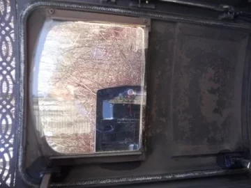

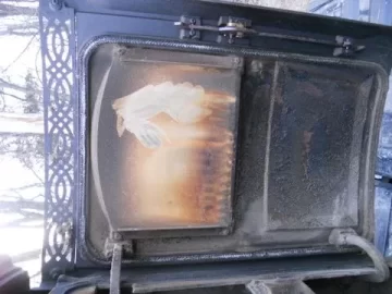

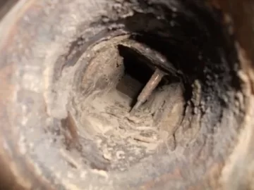

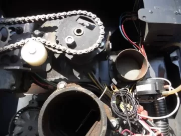

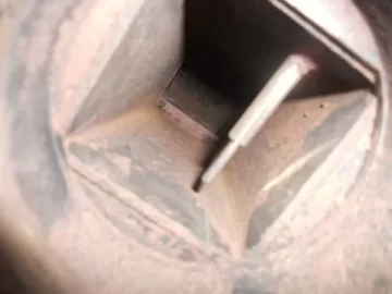

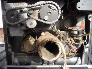

    cleaned stove today from top to bottom.man this thing was filthy as you can see from the pics.
    did the inside of the fire box first.i removed everything to get to the heat exchanger and the combustion blower.brushed and vac everything .gave the burnpot a good scraping and loosened the 2 wing nuts to clead around the igniter.quiet a bit of ash in there so i doubt that area had ever been cleaned.
    glass was absolutely filthy but its clean as a whistle now.oiled hinges on the door and that was the inside finished.
    hopper lid was loose and not locking correctly so made some adjustments on that and its good to go now.

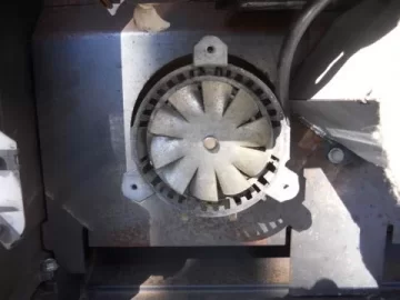

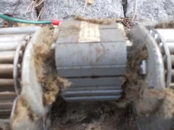

    removed the back cover and man what a mess.this area of the stove was a disaster.dust and hair up the wazzu.
    i removed the convection blower and hit it with some compressed air.made a huge difference.reinstalled and runs good now.
    removed the exhaust probe and cleaned that aswell as the exhaust port on the stove.

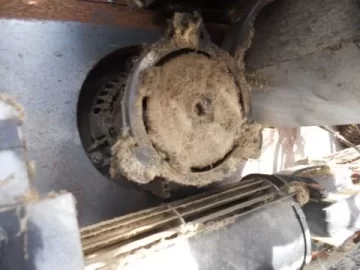

    combustin blower was definately the worst.absolutely caked up with furballs and dustbunnies.couldnt quit figure out how to get the blower disconnected from the stove but iwas able to clean it real good and blasted it with some compressed air.
    next i hooked up the leaf blower to the back of the stove and let her rip.the stove is now clean as a whistle.
    auger motor was good.i blasted that with compressed air and seem to be running as it should.
    also removed the fined from the box by the auger motor.this was FULL of fines.
    im gonna post the pics and follow with a few questions

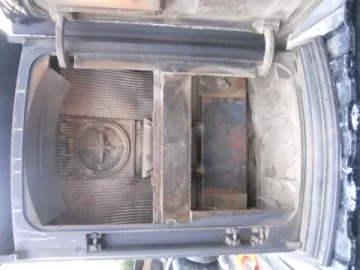

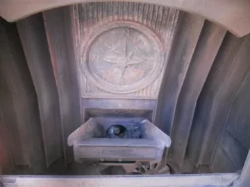

    and this is how it looks after i was done.

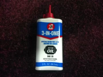

    is there anything to be oiled on the auger system,convection blower or combustion blower.can i actually take the comb blower right uot.it doesnt seem very accessible.

    Looking forward to some burning pics. Some motors have oil ports on them. But some dont.
    Even the motors I have, that dont have ports get some oil put on or in ths bearing. Some gets inside. How much?? Dont know. But it cant hurt.
    Use the 3-n-1 oil (Blue can) or a SAE 20 weight oil. The auger bearing or bushing could use a drop if visible. IMO
    A Harman owner will know for sure. I still would. As it cant hurt. My Pennies ;-P

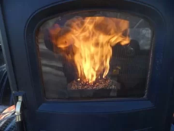

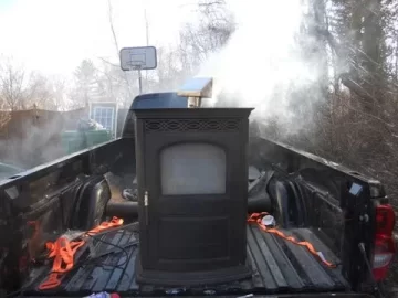

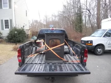

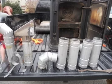

    oops.this was meant to be in the 2nd batch of pics.here she is burning

    Nice score and nice job getting it going so quick!
    Now all we need is the install pic's! :cheese:

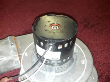

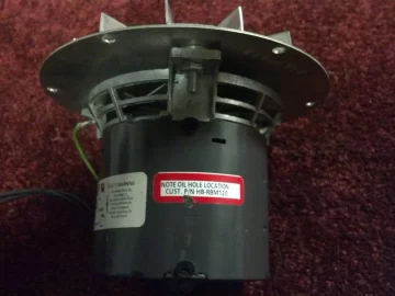

    Here is some pics of motors. One has lube ports (grey motor with black oil plugs) and the other (black no oil ports).
    The grey one, I oil as it says and also add a drop or two to the back bearing (visible, same as black motor).
    The black one, I put oil on the highly visible bearing on the back, then I also hold the motor on an angle and try and "drip" some onto the front bearing. .
    Some motors look completely different than the ones I posted, but still have bearings somewhere. Just have to look a little. A drop or two wont hurt a thing. Again, some people can get 12 yrs on one motor and never lubricate it themselves. But I dont seem to have that good of luck, so I manually intervene.
    Last pic is of the 3-n-1 oil. Not the Black and Red bottle. Blue and White.

    Nice job. I guess you're confident in your rebuild. First burn in the bed of the pickup truck :)

    I like the pic of the stove burning in the back of your truck. We could start a whole new thread on "How I powered my Chevy Truck with a pellet stove" :)
