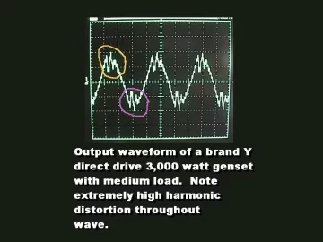

A inverter generator (at lleast the honda and honeywell) make a power curve like this:
but a regular generator (this one was from costco)
The bottom one is good enough for a lot of things, but I would be careful with using it and electronics.

Nice waveforms but can you even get an inverter 220 volt genset? I've seen scopes of the champion gensets that look almost as good as the Hondas. Figure, there's a rotor spinning in there with magnets so it must be pretty smooth. The noise must be from the brushes scraping along.
It is kind of baffling why a generator would produce the choppy second picture. I can understand a modified sine wave inverter doing this, the generator rotor should cut the flux in a pretty controlled manner though./ I believe the big Honda inverter genset is 220v, Randy
Poor windings and skimping on the design and materials used in the stator/rotor. The big Honda inverter certainly is pricey.

You were right Maverick, I was able to find scope outputs for my champion genset as well as a more typical other brand genset. Seems the Champions are spec'd at less than 4% total harmonic distortion which is quite good. Not as good as the inverters but for 250$ and a honda clone engine I can't complain.
