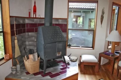

Hey all,
I know nothing about wood stoves, but we just bought a house that comes with one. We wanted a house with one ever since we rented a cabin in the woods for a weekend and spent most of the time sitting in front of it's wood stove and experimenting with the fire. Much better than tv!
According to the disclosure papers it's a Morso 1125, and it doesn't look terribly modern. I think it has a screen door that fits on it but no other way to view the fire. So should we upgrade it to a new stove? Would that involve changing the chimney piping or can we just swap it out?
How large of an area does this model heat?
Thanks for any answers!

I would recommend upgrading. Have the chimney inspected to be certain it is in safe operable condition. Chances are it is and you'll be able to pop a new stove in its place.
I say upgrade because: that isn't a modern stove, it looks like the door has been modified, THEY ARE SO STINKIN UGLY! :)
Hope that helps. If you plan on upgrading, be prepared to take on a HUGE numbers of stove possibilities and the difficult choice that will ensue from SO many good stoves being on the market right now.

This is actually quite a great stove! It heats up a storm.....
Beauty may be in the eye of the beholder, but this was certainly an advanced design for 1978.....and was not a creosote factory like many stoves of the era.

Well, I certainly won't disagree about the looks, it's not going to win any beauty pageants. But then again some of the more decorative-looking stoves with gothic arches and what not would look pretty odd in this house.
It's good to know that it's a great and well designed stove, and not too badly polluting. So how much sq footage does this thing heat, anyway? How much would using the screen and having the doors open impact it? And would doing that set one of our many furry pets alight?
Hi Indie, welcome. If it were me, I'd try it out for a season. Morso makes good stoves and if you have bigger priorities, it might work fine. However, if you're hankering for a view of the fire and want a new cleaner burning stove, a new Morso would probably fit right in there. Regardless, have the flue cleaned and checked out for condition so that you know where you stand in that dept.
If you do get rid of it, don't sell it cheap!
As to heating capability, I would rate is about 2500 square feet in a mid-atlantic climate, and perhaps 2,000 in New England - that thing can rock! Look at all that radiant surface on the front slope - and the triangles add even more.....
That sucker will warm your hands for certain!

In case the operation of the 1125 is a mystery, it takes the primary air into the firebox in two ways - one is through the hollow door handle and the other is through the seal of the doors! The handle is designed to rotate and allow the doors to slightly offset the front of the stove and allow air inlet around them.

Re the stove, it's not what I'd call classic lines. Swap it out ASAP because it's beyond ugly. (sorry)
The hearth pad, however looks real nice! A heartstone woodstove with cafe soapstone accents may complement it well.
Looks like you might have eight inch stove pipe? You'd have to swap that to six inch stove pipe.

If Indie does decide on a stove change, why would one swap out the 8" pipe if it's in good condition?
