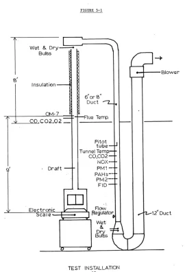

    Another thing to consider is the controlled draft setup (see attached photo below). Necessary, of course, in order to get repeatable results, but not representative at all of the way most folks will burn. Sluggish draft at startup, leading to excessive draft as flue temp rises during warmup, then a reduction in draft as temps stabilize during secondary combustion, then dropping to very low levels during the coaling stage. I'll be willing to bet that the guy who stuffs his stove to the burn tubes then shuts it down for the night with the primary barely open is spewing out a lot more particulate matter than his "clear" flues gases exiting the stack tell him. Cleanest burns reported in this study were during the highest burn rates - something most folks fastidiously avoid in their attempts to extract the last blessed BTU from their wood.

    True, but I think the EPA test rigs all use controlled draft setups. One can only have so many variables floating at once - it makes total sense to me they'd tie the draft down.

    I'll go back to the green wood thing again only because of what your comments imply about the test results, but I don't want to continue to hash this out here on your thread about the Kent stove itself. Maybe on another thread...?
    Yes, the green wood needed more air to achieve maximum burn rates, he even says so in the text. However, the overall efficiency numbers don't lie. There was not a significant loss of sensible heat up the flue due to the extra air being introduced. Yes, some dilution effect is evident, especially is the open stove, but that doesn't support anecdotal evidence of massive amounts of creosote deposition in residential chimneys venting stoves burning green wood. Just the opposite is reported here, and the dilution effect is clearly aiding this... to the benefit of green burners everywhere.
    If you examine the air:fuel ratios, there was not a significant amount more air actually needed to burn the green oak in either stove tested with it. Even at a burn rate as low as 0.7 kg/hr, the conventional air-tight was using less air burning green oak than the Lopi used burning the dry fir test load. Except for a few outliers, the data set shows that the Blaze King used almost an identical amount of air at all burn rates with either the green or the seasoned oak. Which, as I mentioned above, is reflected in the overall efficiency numbers.
    Similarly, if massive amounts of PM were exiting the flue unburned, this would have been reflected in both the combustion efficiency and overall efficiency numbers, and this is clearly not the case. Besides, the sensors and filters catch all of the emissions, so dilution wouldn't affect either the g/hr or g/kg numbers.
    One last thing to say is that, although it was called "green" oak in the report, that doesn't mean it was fresh-cut. Newly harvested oak generally has a MC of about 80%, not the 41% stuff they used in the tests. And 41% dry-basis is not 41% water by weight, it is 29% water by weight. That's only 9% more water per pound of wood than the "seasoned" stuff. I find it frustrating that, even in a scientifically controlled study, the author included both ways of expressing moisture content in different places within the same report. No wonder everybody gets confused about this essential bit of information.
    And that's all I have to say here about burning green wood.
    Considering the stated +/-25% uncertainty in the Oregon weighted averages, the only really significant fuel factors across all the tests and burn cycles was for the production of elemental carbon (soot), and NOx production (assumed... based solely the performance of the Blaze King - a catalytic stove commonly thought to produce high NOx anyway). The major contributing factor in this study was the appliance effect. The better stoves burned both cleaner and more efficiently regardless of the fuel type - green oak, seasoned oak, or doug fir. Seeing as how that was what was being investigated to begin with, we have a clear winner:
    The stove is much more important than the quality of the wood... at least in this study.
