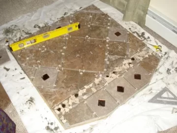

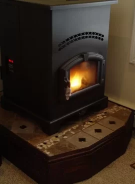

    Mine was not bolted to the pallet, the holes were probably for holding it up for powder coating ect. Funny you should mention "overkill" on the hearth pad cause I am glad I got my way :) My boyfriend wanted a cheap hearth pad I wanted to build a really nice one which is what I did :) He said you don't need to use backer board just the tile on 1/2" plywood will be ok.. nope I wanted to use backer board whether I technically needed or not. Here's some pics of my custom hearth :)

  10. Defiant
    Defiant

  11. abostongirl
    abostongirl
    New Member 2.
    Mar 7, 2012
    4
    0
    Northern NH
    Thank you. No woodchips just tile and glass.

  14. Eatonpcat
    Eatonpcat
    Jul 24, 2011
    2,070
    956
    Eaton Township, Ohio
    I agree that's really nice!
