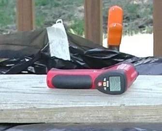

Absolutely. I think one of these should be included with every wood boiler. Make sure you put a masking tape target on the pipe - smooth copper is an infrared reflector any you'll get odd readings.

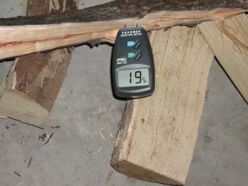

Every wood boiler should also include a moisture meter.....

All true - especially the part about the emissivity of copper. This also goes for stainless and other metal surfaces. Another trick is to use a squirt of high temp black spray paint...this should get the emissivity pretty close to a standard .95 and will hang around on surfaces where heat might destroy masking tape.

I had the two pin version of that moisture meter and it crapped out after about three weeks. I can return it if I want to send it to Hong Kong.
