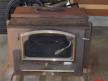

Lets play....name that stove!
Squiner
Aug 22, 2008
201
Maryland
(broken link removed)
I want to do some research on it but don't know what it is!
What do all ya experts think?
Jim
Sorta looks an early model of this doesn't it?
(broken link removed to http://www.lopistoves.com/product_guide/detail.aspx?id=212)
It does look like it, but I guess they only show new models on the websites so it's hard to be sure.
Thanks for looking, appreciate it.
Im starting to wonder if this is a scam or not, I had tried contacting the people and they said its still for sale by email, but will not return phone calls. I too have been trying to figure out if its a knock off or what, I have tried to find a similar stove by looking at google images and can't find one like it.
There are a lot of pre-epa stoves out there that are no longer made. The left hand hinge, slider air control, thin gold accents and bypass should make it easy to identify, but so far I can't place it. FWIW, I don't think it was made by Travis (Lopi/Avalon).

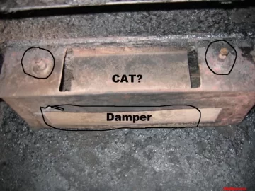

Well im back again about this darn stove. I have finally had some spare time to check it out and it looks to be a cat stove, but the UL sticker on the side is gone. I have searched high and low to find out what stove this is and have not been able to exactly figure it out. Hoping with these pictures someone will recognize it.

Definitely an old cat stove minus the cat. Have no idea what brand? What does it say on that little metal plate on the right below the door?
thats likely a caution tag ,most all stoves have em it tells ya "hey its a fire in there be careful" or some other anti darwinian statement. it will not have serial or model data.
which brings me to the bad news for our stove owner. since the serial tag has been removed strict interpretation of code considers that unit as "unlisted" even though it was listed when it was built due to the Ul tag being removed. therefore you may have to follow nfpa211 standards for unlisted solid fueled heaters. rather than the spec's listed in whatever stove that is's manual.

Unless he can find out what manufacture it is, get the manual and hope it has the UL listing?
I sent an email to Sierra, it looks alot like the Sierra 5300, and I found a Sierra 7000c that had sold on ebay a ways back that looks just like it. ((broken link removed to http://cgi.ebay.com/ws/eBayISAPI.dll?ViewItem&item=130268122875&category=41987))
Hopefully Sierra will reply back.
