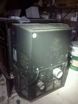

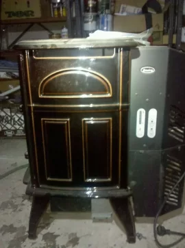

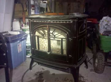

    I bought it.
    I looked at it last Saturday, agreed on a price and he brought it over Wednesday. It is a very old model (March 2006 which looks like a very early one) and hasn't been updated at all but I think it will work out. He bought it new in early 2007, ran it for 3 years and then switched to cord wood so it sat in the basement for the next 2 years.
    On the minus side it doesn't have the new door. In fact just now I opened the door and the glass almost fell out. Doesn't look like there is anything holding the glass in but the gasket. The controller hasn't been upgraded either. Also, it took a long time (10 minutes?) to fire up so I assume the ignitor might need replacing too. The damper is toward the back left corner just in front of the back leg and took a bit to free up so I assume it's the PITA one Scott referred to.
    On the plus side it is the nice brown porcelain finish I like so much on my Castille and the finish is nearly flawless. The motors were quiet and once it fired up it purred along very nicely. He still had all the original paper work, bill of sale, cleaning tool and touch up paint.
    He was asking $1200 and I figured I'd want to knock off a couple hundred each for the door and controller so offered him $800. We agreed on $900 and since he had a trailer and I don't he agreed to deliver it and he also threw in 30 feet or so of flex vent with a chimney cap, that he still had, that I will need for my installation.
    I think it will clean up nice. I'll try it first without, but if I need to replace the door and controller down the road, that's OK. At least I knew what I was getting. Thanks guys for the feedback. I'm happy and he's happy with $900 and some more room in his basement.
    I'll probably start a new thread with my adventures cleaning it up and getting it hooked up and running but for now have one quick question for any owners out there. Are there supposed to be washers at the hinges between the outer door and the side, where the pins hold the door in place? He delivered it with the door and top off and it seems like there should be something to keep the door from just riding on the porcelain coated hinge.
