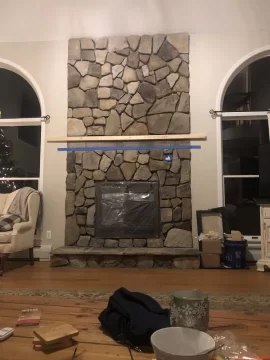

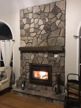

Fellow firewood fanatics: sorry to keep you all waiting on my fireplace saga—was busy with a new job and traveling for a few months, etc etc. Anyway, the company made good on everything, totally redid everything and installed the FirePlaceX Apex 42 (see pictures). Again this is a large reputable installer in the tri-state area, so I was confident they would fix it. It was an incredible amount of work for them to fix their mistake and rebuild my entire fireplace, and I thought their work this time was excellent! The install was completed early Jan, so I had a few days to use it before leaving for travel.
The Apex 42 they installed has been stellar so far (my wife has been using it 24/7 while I’m gone). Despite the insanely low temperatures this winter she is able to keep our 3300 sq ft open-floor-plan house at 70 degrees-plus during the day, without coming close to over firing the stove. Previously we only had oil heat, so with the price of oil these days we couldn’t be happier with the ability of the stove to heat our house—I really didn’t expect the stove to be able to heat the whole house by itself, but it does so easily.

Because we are nerds here... in short detail what did they do? Rebuild the fireplace, install a new ZC then your unit, new chimney liner, etc?
Also you might want to consider a small ember pad in front of your hearth on the wood floor to catch anything that might fall when the door opens. Cant remove a burn easily in the hardwood.

Yes, they redid absolutely everything. They tore the old stove out, rebuilt the fireplace area of my house and added the appropriate steel framing in the house as required by the install instructions, then installed the ZC unit (the apex 42)—I read the install literature for the apex 42, and they did it all right this time; I also had a friend who is a former fire chief check it out for me. The owner of the company did the install himself with his team. New chimney liner as well (a much bigger one this time: 8 inch diameter, per the apex 42 specs). Totally redid the stone face with new stone, new mantle. Grouted everything up of course. Everything has operated flawlessly for 2 months now.
Great idea re: ember pad. Will do that (and by that I mean the wife will pick one out to her standard).
