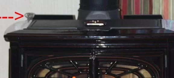

Some of the early Leydens had a problem with the bypass damper coming open during operation and / or not sealing off. My stove was made in September 2007. This date can be found on the name plate on the rear heat shield. This unit was equipped with a device on the bypass damper control that solves this issue. The black stove in the pics does not have this device. The brown stove pics show the device.

  • [Hearth.com] Lopi "Leyden" or Avalon "Arbor"
