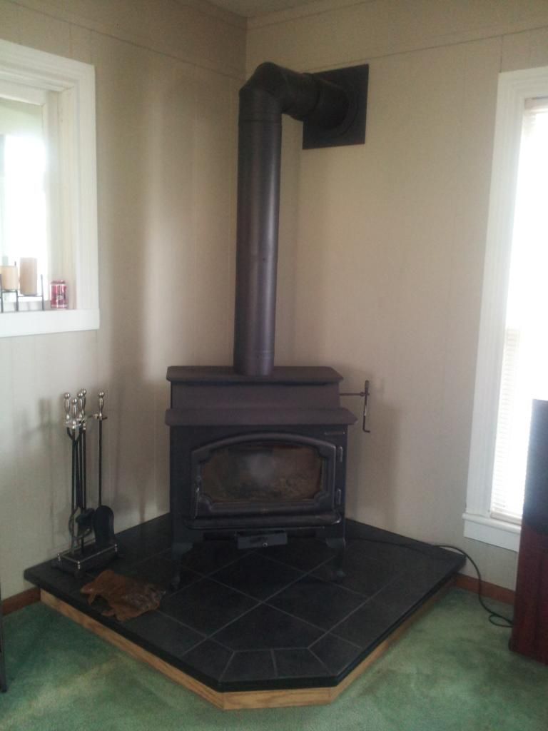

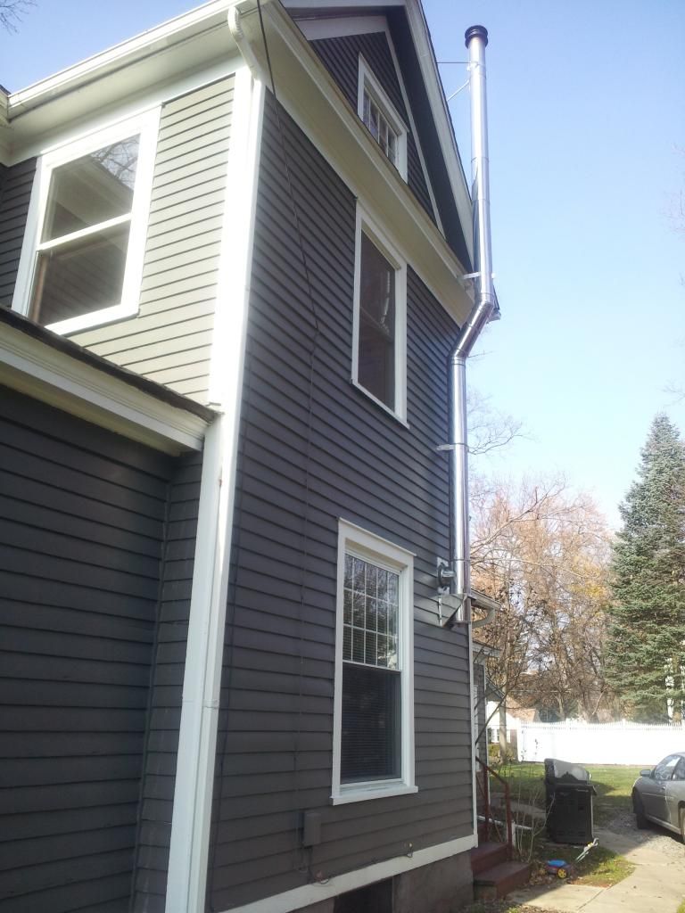

    I believe I have around 20 feet of pipe on the exterior and 4 feet inside
    [​IMG]
    [​IMG]

    24ft total, but with a couple 90s in the smoke path. It should do well. Do you always close the bypass after starting the fire?
