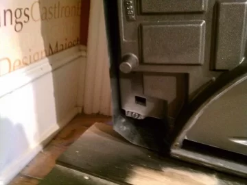

    I thought the holes that feed my Clydesdale's secondaries were unregulated? See the square hole down in the lower left? There is one on each side.

    Woodmiser-I am sure they are not regulated and I think BB said it was not on his 30 so like I said I am confused on what he is saying.
