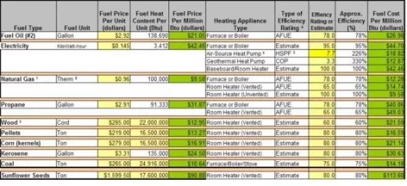

Below is the equivalence and comparison chart for you to calculate the prices in your area.
  • [Hearth.com] LP gas versus pellets ?
