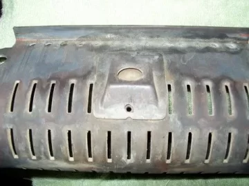

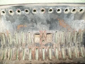

    Well here it goes. This isssue drove me a little crazy, so after much thinking I modified the burn pot
    with a single 1/8 hole drilled right through the tab in front of the ignitor. Going on two weeks now,
    burning a variety of pellets on high/lo and auto/off. Not a single scrape of the agitator on the this spot.
    The additional air prevents pellets from sitting and smoldering in this spot.
    Sorry to be long winded. I will post pictures when I get home from work, may be a new thread for
    the burn pot mod. Believe me it has worked better than I expected.

  16. Wachusett
    Wachusett
    Feeling the Heat 2.
    Apr 12, 2010
    259
    21
    Wachusett Reservoir, MA.
    Here the pictures of the burn pot.

    259
    21
    No drawbacks, none. To date since the mod I have burned 22 bags of assorted pellet brands including:
    2 bags lignetics (blue label), 2 bags Maine Woods, 2 bags NEWP, 10 bags Clean Energy (Lowes pellet),
    4 bags Greene Team, 2 bags Barefoots. No in between cleaning, this was not pellet testing.
    I have seen no negative effects during ignition (auto/off), or constant burning (hi/lo). I used to have to remove the pot and scrape it mid-week,
    now I only do my weekly cleaning. Could probably go longer than a week now.
    I drilled from the outside of the pot to inside, set a pilot/dimple with a punch so the bit doesn't wander.
    The hole I drilled probably ended slightly over 1/8 inch, bit had a little wobble in it.
    Also the way I looked at it if I screwed things up I could buy a new pot for $60+/-. I have pissed away that kind of
    money on crazier projects. :)
