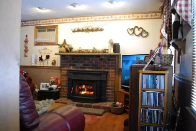

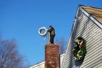

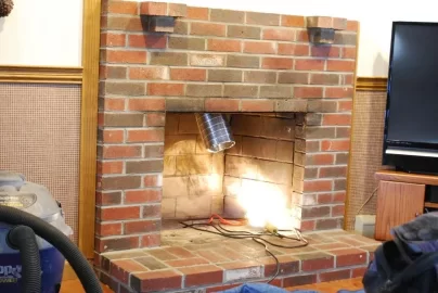

Here's a few pics to show you what a flex liner looks like and how it's installed. I too had to extend the hearth to meet the 18" out from the stove door. I purchased a stone called brownstone (2" thick solid rock) that is laser cut and rough cut, your option. I looks a lot better and it can be placed on the wood floor with a wool rug under it because of the raised hearth. It's just there for ember protection and removed when the stove is not in use. This year I am looking for a rectangle rug to put under the rock. You can get a matching mantle as well.
Good luck.
Good luck.
thats the advanrage w/ flex... just dump it down, no rooftop assembly required.

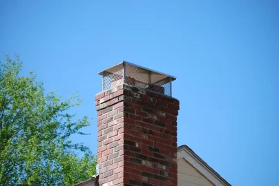

Well, there was a little something to assemble…
