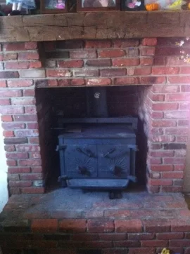

    Hello Hearth.com Members! What a wonderful website! I am so glad I found this forum and you experts as I am in need of guidance.
    Around 1985 or 1986 there was some sort of issue with the fireplace at my family’s home. Some bricks were replaced and an Ahrens two-step liner system was added. Next, my parents had a Kodiak wood-burning stove insert installed into the fireplace. When my father died in 1990 my mother had a chimney sweep “clean” the unit and “close the flue.”
    My mother has since passed and now I’m back living in the family homestead. I really miss wood-burning heat and decided to open up the stove, with the assistance of a guy friend of mine who has a lifetime of experience with fireplaces. We opened the clean out door and saw “duct work.” Obviously there is no flue anymore which makes me wonder what my mom paid for? Anyway, we made a test fire and the stove/fireplace works beautifully.
    [​IMG]
    My friend has always cleaned his own chimneys but was perplexed about the process/need for cleaning what is essentially ductwork. I have the owner’s manual with the stove but there is nothing about regular maintenance. ??? I am burning only oak (no pine) with maybe a bit of apple wood down the road.
    I called Alaska Stove Company but they just regurgitated a line about current EPA standards and how they do not support this unit anymore.
    My question for you experts is: What do you recommend for proper maintenance? My friend has regular chimney-cleaning brushes but will this work on ductwork? How often should we clean?
    Thanks so much for any and all light you can shed on my situation! This stove does a wonderful job heating my two story home and I want to do everything right.

    Can you post some pictures of this "ductwork"? There should be a continuous connection from the stove to the lined chimney. It might be worth it to have a professional certified sweep check the system out this one time. There is nothing like a set of trained eyeballs at the site. Then, once the sweep has confirmed that the stove is correctly and safely setup and your questions about the "ductwork" answered, you can burn with peace of mind and clean the chimney yourself in the future.

    Thanks so much for the reply!
    I could take a photo this weekend then post it.
    The system was professionally installed and tested. I found the paperwork/invoices. Also, it was professionally cleaned after my father died and has not been used since so I know it is "clean."
    I have been surprised that there is nothing in any of my paperwork, including the Kodiak's owner's manual, regarding regular maintenance. ??? For example, when you buy a lawnmower the owner's manual tells you to change the oil after so many hours of usage. My friend has told me that with his regular fireplace he cleans the chimney each spring after the fire season is over. Does this rule of thumb also apply to a stove insert? Does metal tubing require the same amount of cleaning? More? Less?

    The old stoves were pretty simple and maintenance was usually done by a sweep not the owner, so I can understand this omission. Usually it is included in modern stoves.
    Yes, the chimney still needs to be swept regularly. How often will depend on the wood, flue temps and how the insert is run. If the wood is only partially seasoned and the fire is frequently choked down to a smolder, then it may need sweeping every other week. If shorter hotter fires are burned and the stove is not allowed to smolder then it may not need cleaning more than once or twice a season.

    Thanks for the good advice! This coming weekend my friend is going to go up on the roof and take the cap off the chimney and test out his brushes to see if they fit.
