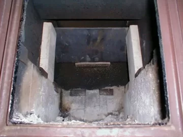

    That reminds me, I pulled my baffle plate out yesterday after a month of 24/7 burning. 5/16 plate stayed flat, no warpage. I had a factory baffle in a Goldilocks since new in 1985 that is straight and flat too. I sat the homemade one on two bricks, stood up on the sides above the first brick course as shown here;
    https://www.hearth.com/econtent/index.php/forums/viewthread/82318/
    Some Papa's already have a second course in the back.
