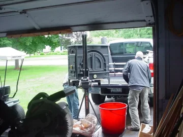

    I had a cast iron Extra Large FA288CCL Vermont Castings Consolidated DuchWest Federal Design Coal/Wood catalytic combustor stove that weighed in at a mere 600 lbs!
    When it was 19 years old it left home to burn up north with a nice young man and it went out on a 4 wheel wooden carpeted dolly with 2x4s on edge to hold it on the mover's dolly.
    I got the mover's dolly at Home Depot for $20 but Harbor's Freight has it cheaper now.
    See link below.
    http://www.harborfreight.com/movers-dolly-93888.html
    Then to get the stove into the truck we removed the tail gate and rented a hand crank hydraulic fork lift!
    See pic below!

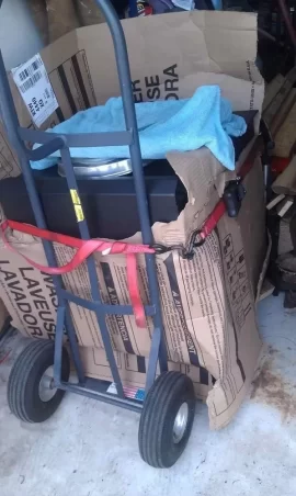

    This is how I moved the Englander 30, worked well. Needed a second person to tilt it back but once it was tilted it carried it fine. Got the dolly seven years ago at Lowes.

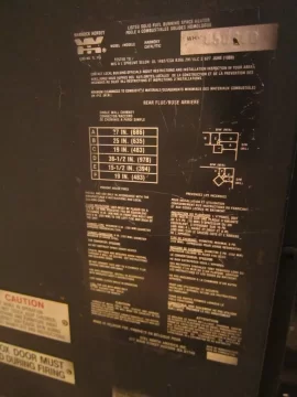

    Here is the tag on the back of the stove, how can I tell what rating I need the hearth to be?

    Yes it is and thank you for the link, I just bought the manual and would be happy to share it. It's not a digital download though so I would have to create a pdf when I get it.
  23. dylskee
    dylskee
    Feeling the Heat 2.
    Sep 28, 2008
    349
    159
    Central MA
    So how will I know what is a properly rated hearth for my particular stove? How much distance do I need from the wall behind the stove?
