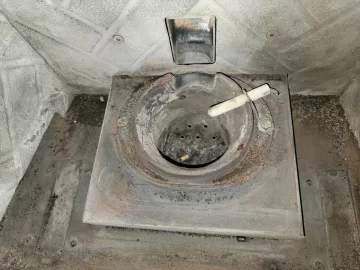

Attached is a pic of the fire pot.
The outside looks immaculate and so I figure if I have to replace some things its still prob worth it? [Hearth.com] Mt. Vernon OE vs AE blower replacement part.[Hearth.com] Mt. Vernon OE vs AE blower replacement part.
Get yourself a cheap endoscope that plugs into your cell phone and look over the inside of the firebox, I think they cost about 20 bucks on Amazon. I also think I'd pull the burn pot and soak it in warm water for 30 minutes or so and get the carbon out of it (see my thread on that I posted the other day).
I have a borescope. Where am I putting it and what am I looking for? I will try to find your other thread on the carbon buildup.
Look for cracked welds and warping. The cast iron pot assembly is removable but will require a new gasket when reinstalling. As far as the motor goes, you want a motor that has the same specs as the original hp, amp, rpm, rotation.

Especially in the corners and around the top and around the door opening
