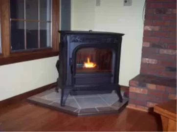

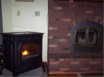

Here is a shot of my new 2005 Harman XXV. You may notice I am a real firebug, having a pellet stove right by my 1987 BIS (Built In Stove) made by Security Chimneys. Last Year I burned a Harman Accentra and have now traded for the XXV. Last year we heated the whole house with pellets, never turning the LP furnace on one time! I didn't keep good track of how many pellets I burned last year but will have an accurate count by end of the season.
We switched to pellet last year because my wife went to work full time and it was not convenient to keep the BIS going.
How would I compare the XXV to the Accentra? Wow, they are both great. I think the Accentra was a little quieter than XXV by a little bit. I like the bigger glass of the XXV and the one way glass. You can not see into the stove when its not on, thereby not seeing the dirty burn pot. The Accentra glass seemed to stay a little cleaner but being some smaller may be why. I have fallen in love with the new XXV's styling. That's the real reason why we changed. All in all, I think they are both equal in quality and both do what they say what they will do.
The XXV is a real heater!

Yep, nice stove, and the cast iron is US made as well! Its quiet, quieter by far in my opinion than the rest of the line. Imagine how this thing will look when Harman comes out with their enameled version! Lovely installation as well. One thing though......it seems a bit close to a window....if outside air intake is installed, the outlet needs to be 18" from a window or door, if no outside air intake is added, then the outlet has to be 48" from an operable door or window. Im guessing its an operable window because it has a screen. ;-)

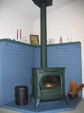

I agree, the Harman XXV is a great looking stove, I painted mine forest green (photo attached) and used the top vent adapter option. Would be nice if they had the enamel finish.

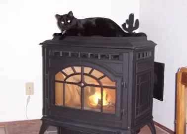

F350R, I like that Saguaro cactus and kitty cat(?) you put INSIDE the stove. I assume those are NOT Quad options. :)
A friend of mine made the catus I don't have a plasma cutter. We had been talking about making something like that, soon after he saw some figures simular in a stove store so we decided to make our own. He has a plasma cutter so all we needed was some 1/8 material. I put the patterns together on the computer and he cut them out. Both cats were timid of the stove when we put it in this fall but both lay in front of it when it is cold out. The older cat seems smarter and sleeps on it when its really cold out. Both cats are black although one is about twice the size of the other so we call them fat cat and mini me.
