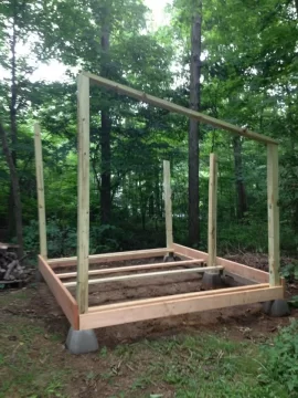

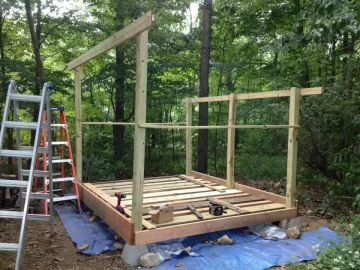

    Hello everyone,
    Long time lurker, but first time poster. I use this forum to get educated on everything wood burning related. As a thank you, I thought I would finally contribute with images of the woodshed I am building using this forum as a guide.
    It is still a work in progress (need the sides and back put on, plus finish roof trim) but it is ready to hold some wood before the winter.

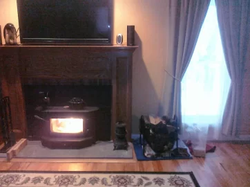

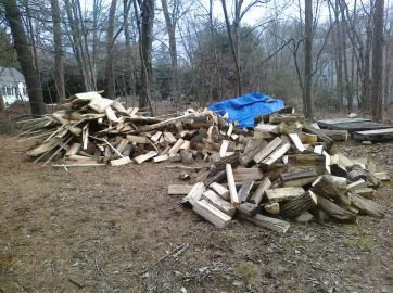

    Also posted a pic of my fireplace insert (Regency I2400) and woodpile waiting for shed)
    Thanks again and ask any questions you may have.
    If interested I will post a few more pics once the wood is in it and the sides are complete.
    woodpilebig.jpg mefirepitmate.jpg gettingstartedshed.jpg sidebeamsup.jpg roofbeamsup.jpg meonroof.jpg daroof.jpg

    What is the span on those "joists", and is there any center support? It looks like it is a least 8', no center support, and 2x on their sides topped with pallets. Maybe I'm not seeing everything, but if that's how it is build I'd be seriously concerned about major sagging when you load that baby up. A couple cord of wood is going to be pushing 5K lb or more. Would you feel comfortable parking a full size truck on that floor?
    Not trying to be negative here, just don't want to see your floor bend or blow out after all that hard work.

    Yes, I built this as cheap as possible. Busted up a lot of pallets using a Milwaukee Sawzall for the floor and some support.
    Used credit card rewards to get lumber I needed, and bought whatever shingles were open at the Depot because they were sold at 30% off.

    Yeah the picture does not really show it but I have six concrete blocks with two 8x8" boards running lengthwise down the center and six 2x10" running the width as a the sub floor. The pallet wood is on top of that. The two by fours you see in that first pick were there to keep everything measured and straight for that sub floor.
    I guess I should mention the floor dimension is 10 feet wide by 8 feet deep and the roof is 12x10 feet.

    Cool. That sounds sturdy enough then. The in-process pictures looked like trouble but it seems you have it sorted out.

    Gotta agree with lukem, if those joists shown in the first pic are all you did, you're likely in for a disappointment somewhere down the road.
    Would have been a bit more sturdy by going perpendicular with the boards on top of the joists, but I'd still have put in more joists.
    Just trying to help.
    You will definitely enjoy getting wood from under that rather than from under tarps. I did the same the spring of 2010 and wish I'd done it sooner. Doh!

    I'm not really sure on the type of wood. I really have to get better at that. At the moment my area has had a ton of severe weather events, so I just drove around the neighborhood with my trailer and picked up whatever was lying in the road. I rented a splitter and got what I could. Damn near destroyed by back though picking up some of those logs. I know some where larger than two feet in diameter. I have got to find a better way (or a friend) to get wood. In fact I came here today looking for reputable wood sellers in my area. I have bought wood twice and twice I have felt ripped off.
