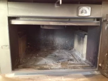

    Hi all,
    We recently bought a house here in VA that has an old Derco Grizzly stove (from what I've gathered). This house was built in 1992 and the stove was installed a couple of years later. I have little to no clue about such stoves and was going to get it removed during a chimney clean last month but the guy talked me out of it.
    One thing I failed to do was ask him how to operate one and I've tried to no avail to find a copy of a manual online. After having watch a couple of videos online, I decided to give the stove a swirl last night. Got it up to the point where I placed the first log in. Fire was burning good and I then proceeded to close the door. The fire immediately started to dim. I thought I had the side drafts open all the way but yet it started to dim. So I had to open the doors again and this time smoke started filling into the room. I know I did something wrong here but I think we could have done with better firewood too.
    Question....what is the blower for? I noticed at the side it reads Thermal or Manual. We had it on then turned it off by switching to thermal but some time later it activated on its own.
    I check the combustor and it looks to be in good form. I don't think the previous owner had used this stove often enough. And yes I did have the top/vent open. We had to keep the door open slightly and let it burn until it died out.
    Will welcome any advice. Attached are some photos. Thanks!

    That lever on top appears to be what engages or bypasses the cat. You'll want to start the stove with the cat bypassed so that smoke goes straight up the flue. Once the fire is going strong and the firebox is up to temperature, the cat can be engaged.
    But before you try that you need to establish where the air control is. What does the lever to the left of the fan switch do? Is that the air control? If you think it is, try it once you have a good, lively, dry kindling fire and the stove door closed. If this is the air control, the fire should burn more vigorously with the air control in the open position. Try running the stove with the cat bypass left open until you get a hang of it and can burn a decent fire. Be sure to burn only fully seasoned, dry wood to ensure best success.
    PS: Are you sure it is a Grizzly? I think of them as having 2 doors. I haven't found a picture of this one yet, though it might be the Super Achiever FXP-1-LEX? If so it is EPA listed.

    Great. Did they inspect and gently clean the cat when they cleaned the stove? That should have you off to a good start.
    Your stove looks to be in very nice condition. It could have many years of heating remaining in it's life. I'd try to learn how to run the stove with the cat bypassed for a while. Once you have the hang of running the stove at different air settings and can get the stove to run in the say 500F range, try engaging the cat fully. It should start glowing bright red Then, you should be able to back off on the air until the fire is somewhat lazy, but the cat remains glowing hot. Go outside and there should be no smoke visible from the chimney, just heat waves. And remember, burn only dry, well-seasoned wood for the best success.

    I don't think so but I did take a look at the cat and it appears to be clean. Will get a pix up and thanks for the additional advice. These stoves are all new to me. Years of living in NYC and all we had was a plain exposed fireplace. Burning firewood then was straight forward and a no brainer. I'm glad I'm learning all this from the pros!
