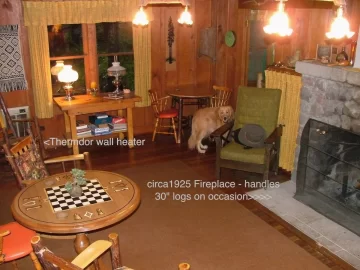

Hi Folks! Our family has a circa 1920s cabin at 1900' in the middle of second growth fir & cedar - not much sunlight. It's 1100sf, 2 story single wall construction on posts and piers and completely uninsulated. The main heat source is a huge stone fireplace that draws better than most on the mountain. Only smoke up the living room when burning wet wood, There is an old Sears wood/coal cook stove in the kitchen that is a bear to use so we rarely do, using the electric oven to heat kitchen. In addition there are two Thermador wall heaters - one in the living room and one near the bathroom in the master bedroom. The cabin is used alot from April to October and sporadically during winter. There are frequent power outages from limb fall and weather.
At home in town we gave up our wood fireplace for gas logs, then a Lopi NG insert and learned how expensive a big open fireplace can be. No gas lines at cabin but plenty of wood - so we are thinking a big wood insert for fireplace and small efficient wood or LP stove to replace old wood cook stove. One family member is very concerned about safety of old wall heaters and proposing replacement with LP wall heaters.
Seeking advice on all of the above, especially the big insert for the fireplace and kitchen stove. We want a big viewing area don't want to rely on blowers for heat. Our gas 31K btu Lopi heats half of our ranch house without ever using the blower. We have three seasoned cords cut to 20" so we need a firebox that will take em. One of family members is concerned that an insert or stove will make Somores extinct so we also seek reassurance regarding desserts. Thanks for your patience.

Looks cozy! A small freestanding wood stove on the fireplace hearth would probably do a great job of heating your cabin. Most inserts rely on blowers (and electricity) to get the heat out into the room. I'm sure you'll get plenty of other (and more informed) suggestions.
Welcome. I don't think you'll need much more than a single 2 cu ft stove in our climate to heat 1100 sq ft. very adequately. The question is where the heat will do the most good, in the living room or in the kitchen. What area is most open to the rest of the cabin?

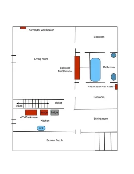

Great questions! I'm on the road and can't supply dimensions until weekend. I can attach a rudimentary floorplan of first floor - upstairs is divided into 3 equal size sleeping areas. There is a grate covered hole in the kitchen ceiling to allow heated air to warm the bedroom directly above.View attachment 75811
The floorplan file didn't seem to make it. What format was it?
This is probably going against the grain here and is just my opinion, so take it for what it's worth: For me part of the pleasure of a woods cabin is sitting in front of the fire on a cold evening... and that old stone fireplace just looks right in that cabin. I'm guessing the Thermador wall heaters are electric? If so, and if you can get propane tanks in, you might consider replacing the heaters with new propane wall heaters, or perhaps a very small freestanding gas fireplace in the MBR.

Sorry bout that - I'll try again.
Great, that worked fine. I think you will be fine with just an insert or stove in the living room. You could keep the kitchen cookstove as a supplemental backup for a year to see how it works out. If the kitchen/dining area is a little cool you can use a box or table fan at the outside wall near the screen porch door. Place it on the floor, pointing toward the woodstove. Run it on low speed. It will blow the cooler air down low, toward the woodstove. The denser cool air will be replaced with lighter warm air from the stove room. Running this way you should notice at least a 5F increase in the kitchen temp after about 30 minutes running.

Wow - you folks are awesome! Joyful s right about the fireplace forcing removal of layers and open windows. We do enjoy the monster but we go though about a dozen 22" quarter rounds a night in winter, and of course overnight burns only happen if someone adds fuel at 3 or AM. Begreen I'll be able to measure the fireplace tomorrow.

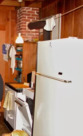

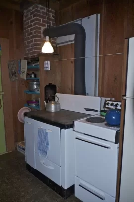

In the meantime here is a photo of the wood/cookstove in the kitchen. We really are looking for something easier to light and get going in winter. To light it we have to have both outside kitchen doors open which is a pain when the temps are in the teens or twenties. We've been thinking a small efficient, millivolt wood or propane stove to replace the cookstove could be through wall vented to the stair landing in the living room - warm air rising up the stairs for a temperature bump upstairs. Any thoughts on user friendly, easy and quick to light, small LP or wood stoves for the space where the old stove is now?

If the main area stove could heat the place, what would be the purpose of the second stove? I'm not saying don't do it, but I want to understand the goal before making a recommendation. Some questions are:
Do you still want to be able to cook on it or bake in it? Are you looking for simple utility or do looks matter? How tall is the chimney that it is connected to, 2 story? What is the width of the space the current stove is in?
I'm thinking a Jotul 602 offhand, but it will need proper clearances.
I blew the cabin's SF in my 1st post - should be 2000sf. Here are the kitchen dimensions 9' wide x 23'3" long with 8'9"ceiling ht. We don't really care about cooking or baking on the stove. Kitchen is always cold when using just LR fireplace and no fire in kitchen cookstove.
The stone fireplace dimensions
fireplace - 43wide front
back27" wide
arch height 30-35-30
bottom depth 27" - top depth 16"

Unless my eyes are playing tricks on me, that brick chimney stack is sitting on a wooden kitchen cupboard. Is gravity less significant in Oregon, or am I missing something in that photo?
With a proper insert you are going to realize a lot more heat in the house. You can go for a larger insert if you like to accommodate the 20" wood or it looks like you have enough room in there to put a full size stove. The Avalon Olympic can be installed either way and will handle 24" wood. That should heat the whole place. You might need the fan trick I mentioned, but it should work out.
But if you expect to usually be running a kitchen stove too, then you could get away with a medium sized living room stove and a smaller one in the kitchen. You'll probably need to cut the wood shorter for that stove.
