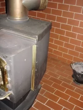

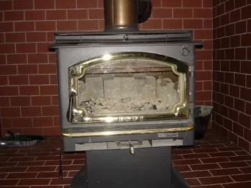

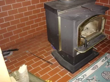

    HI,
    We just bought a home in Rhode Island. It has a LOPI stove as well as a central heating system. The problem I have is that I can't identify which model of stove we have. I need the model number as I want to refurbish the stove to 'as new' condition.
    The previous owner just did not maintain the stove at all. So far I have discovered that the gasket on the glass was around an inch too short and not adhered to the glass in any way. The glass actually rocked back and forth in the door. The door gasket itself was leaking very badly as well. There are three firebricks in the roof of the stove. Two are pushed to the right (as you look into the firebox) and one to the left. This leaves a gap that would nicely take a fourth brick. The problem is that I don't know if it is supposed to have four or not. In their current configuration the gap is to the left of the chimney hole above.
    The sticker on the back which usually identifies a Lopi is almost completely torn off so I can't use that to get a model number. I think the stove was installed in the early nineties.

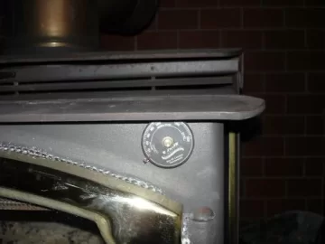

    I have attached a few photos of the stove.
    Note the thermometer wheel in the upper right hand corner of the front. This does not appear on any of Lopi's current models (as far as I can tell). Is there a way I can calibrate this??

    Huh, doesn't look that old, really. It looks really nice, in fact, you might just need to do some gasket work... How big is it? It looks almost as big as the liberty, but the Answer (smaller stove) is the only freestanding stove that doesn't have a step top in their current lineup. It's very similar to their Revere or Freedom inserts, - I wonder if the inserts were ever done as freestanding because that looks like it's supposed to be like that, not like it was just rigged up that way.
    Take some measurements, and you can see if it's the same as the Freedom?

    The opening of the firebox is 21 inches wide. The total height is 35 inches (includes the pedestal) - without the pedestal is is 23 inches high. The greatest width is 30 inches. The depth (not including the shelf to catch ash is 23 inches.

    Sounds like it's the same as the Freedom insert, to me. You can download the manual for it from the link I left above, it should give you a couple diagrams of the firebricks and all that you can use to doublecheck. You can also call a local dealer of Lopi and get THEM to check with Lopi whether the Freedom insert was ever done as a freestanding, though I suppose it's possible that your homeowner did that him/herself. Unfortunately you can't reach Lopi directly as they do everything through the dealers. But their website has a lot of neat info on it, videos etc.

    That's a nice looking stove! Love the look of the brass! Good luck with the restoration..

    I emailed a tech at Travis Industries (makers of LOPI stoves). He has identified it as a FLEX-95. The manual he sent has a November 1992 date on it. Judging from the manual the 'flex' aspect is because it is designed to be either freestanding or an insert.
