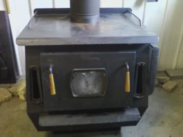

    Here are a couple pics. When cold, the flapper is closed with the knob pointing to the 2nd lowest setting. Does that sound right?

    Looks just like my old stove. Had colored ceramic inset pieces on the front.
    Good you found the problem.
    Easy fix?
    Next deal with the creosote forming itself. Wet wood most likely.
