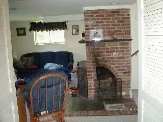

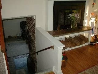

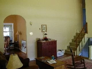

Here are pics - you'll notice the fireplaces back to back, the arch cut from living room to dining room sunroom, and the den taken from the laundry room which is adjacent to guestroom/playroom

In that case I'd put an insert into one of the fireplaces in the den. That would be so close to the stairs that the heat will come up the stairs easily. It will be warm down there, but that's o.k. A friend of mines parents had a very similar house in highschool, and they had the stove downstairs in their den. The bedrooms upstairs were not all that warm but the den and main level were easily heated by the stove at the bottom of the stairs, exactly where yours will be.
If your goal is to get as much heat as possible into the bedrooms, I'd say that the stove should be in the main level.
Let us know what you decide.
Yes, looking at the pics, I agree with Warren. You should be able to get good heat up there and into the living room. KD
I would think the down stairs den would be the "best bet" for over all home heating. You could put it on the second floor but your going to have a BIG issue with heating the down stairs that you also spend most of the time. If on the second floor your down stairs is going to be cold and you would have to run a small heater down there to keep up with the rest of the house. The chimney being so close to the stairs a lot of the heat is going to go up right away. A ceiling fan down stairs would transfer a lot of the heat. Again , I would say down stairs.
