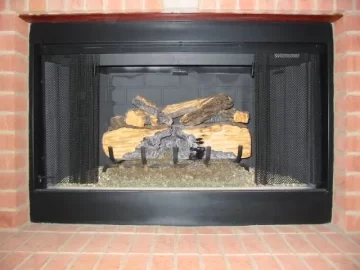

Here's a pic of the Majestic Insert (BR42I)

Gas insert yes?
That mortared edge may just be filler. What model Majestic? Can it be replaced with a higher efficiency gas unit? Some of them really put out the heat.
It's a normal wood burning insert with gas lighter. I just added a R.H. Petersen gas log unit which I don't use very often. Heat goes right up the chimney!
The firebox is a Majestic BR42I
It looks like this unit slides straight in, no side or top flanges. So the question is, can the Majestic be pulled and a pellet insert replace it. Or would you prefer the convenience of a high-efficiency gas insert? I don't know enough about this type of install to say yea or nay, but would have a good stove shop come out and assess your options.

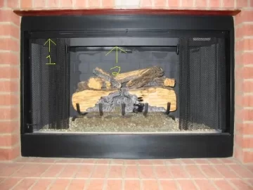

A few things that may or may not help.... (see notes on picture...)
You may be able to get a little more height out of the unit. See the part of the unit that the screen hangs on (1)? That is removable. Only a few 1/4" self taping screws holding that on.
The part that helps the smoke stay in the fireplace and go up the flue (2) is commonly removeable also.
Both these parts do not affect the insulation value of the firebox so there shouldn't be any problem removing them (from a safety stand point).
The bigger problem I see is the fact the unit is recessed into the brick. The brick to brick opening is probably smaller than any surround panel and the unit must be fully into the fireplace. The way around this would be cutting down the surround panel allowing it to slide flush against the unit.
As far as pulling the Wood Fireplace out and replacing it... Can be done but what you would have to take of the brick facing, remove the unit and all the chimeny in the chase. Definetly do-able and not that uncommon but quite a bit more costly. The advantage of doing so though is that you could then put almost anything you want in the spot and finish it however you please.
Josh. Thanks for the comments on the insert. Quick question. I thought the sourround panels should be bigger than the brick opening on the firplace as it would sit flush against the brick and cover the hole. Isn't that the way they install? It sounds like your saying that the stove and surround has to fit entirely inside the brick opening? Me confused!
If it were a masonary fireplace then flush with the bricks would be correct.
If I'm seeing the picture correctly the unit (which is called a zero clearance wood fireplace) is sitting back 4 -6 inches into the brick front. If the surround panel where to push up against the brick the insert would be hanging out of the fireplace the depth of the brick. You would then have a gap from the hearth to the bottom of the insert to the bottom of the insert with a depth of the brick. enough so that you could fit you hand into it. The insert must be fully into the fireplace.
To give you an idea of what that picture actually tells me - it is probably a trapazoid metal box framed with wood and a brick wall was built in front of it.

You have that exactly right Josh. One retailer told me that they sell support kits to prop the insert up from the bottom of the hearth. Wouldn't this work? I'm guessing that the vent pipe is the only really part that must be entirely into the firebox right. Other wise how would the freestanding stoves work. They're all open to the air except for the exhaust pipe right?
Well, I guess this area is a bit gray. Would it cause a problem to do so?... probably not. But that can't be guarenteed because an insert isn't tested or listed to stick out of the fireplace (at least non I know of). Maybe the dealer has a unit that is approved to do so, I don't know. But I would make sure the support kits are unit specific and that the manual says its ok to do so.
Their are alot of things in the fireplace buisness that common sense would make things seem alright, but if it is not installed according to code and the manual then there are no guarentees on operation or safety.
I don't see much of a problem with double wall pellet inserts sticking out a bit. The top temps of these are usually very low, which eliminates the most obvious danger of radiant heat upwards. Our installers would use bricks or firebricks to hold the unit up, and then make a sheet metal skirt which matched the contours of the stove. This would hide the brick and be painted the same color as the stove....looked like part of the install once we were done.
Yes, only the exhaust pipe goes up the chimney and should be well sealed. As has been mentioned here before, it is probably legal not to line the entire chimney, but a complete lining is the job that many dealers - and some manufacturers - suggest.
