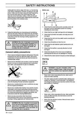

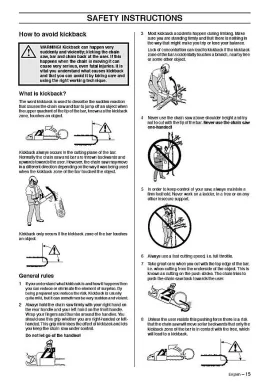

Here are a couple pages out of the Husky manual describing the process in more detail

You've pretty much got it covered, Corey. Thanks for scanning and posting the brochure--that's all good information.
The tip of your bar is what you need to keep an eye on. That's another reason for not having a longer bar than you need. For my money, the most dangerous place to contact a log, from a kickback point of view, is at the end of the log. Regular chain saw chains are not designed to rip-cut wood; they're cross-cutting tools. If you hit the end of the log with the tip of the saw while the chain is turning, it will jam. And when it jams, all that force has to go somewhere, usually forcing the tip of the bar up and back towards you.
A major cause of kickback is when you've filed your rakers too low. A brand new chain right out of the box probably wouldn't kick unless you went out of your way to make it happen. That's why guys like the one in my avatar can get away with bore-cutting, which is basically just revving up the saw and poking it into the wood with the tip. I don't recommend that anyone try bore cutting without some training or experience, but it's a legitimate method for professional cutters, and very useful in directional felling--if you know what you're doing.
