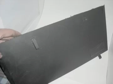

    I have a friend that has this stove. With the lose ash pan door, the stove will stop and when you hit the On/Off button the # 3 light will blink. It was professionally cleaned and only 1 year old. Both latches broke off the ash pan door! What a PITA.
    Did anyone else have this problem? Is there a better latch than the OEM replacement? Is there a modification that works better?

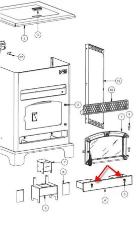

    See manual > http://goldeneaglestoves.com/Manuals/5520.pdf
    Page 25 Ash Pan Latch Part # 891327

    Hey Don what does that area actually look like?
    A real picture might get a possible solution.
    Those diagrams are usually on useful for locating a part on the stove.
    Please remember a lot of us are old and need a good clear sizable picture.

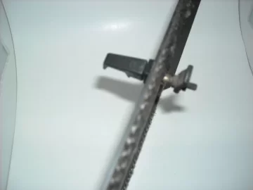

    I have a 5520 also and the interior latches are junk they are a bent piece of metal that is too short to catch the interior of the stove front hence it fails to keep the ash pan tight hence an airleak and improper burn . What I did with mine is I got a longer piece of metal with the same width (just about a half inch longer , used their piece as a bending template bent the new ones drilled them and attached to the plastic latches and viola the longer length on the top end catches the frame and pulls the pan snug and seals it befor I did this my burn pot always overflowed and had to empty it at least once per day now I can burn it for days without any problems.
    [​IMG]lengthen the inner piece(right side) shown in photo (attached with screw and two nuts and a lock spacer on the bottom of the thing.

    Good idea. I ordered new ones from breckwell and had to put approx 6 washers under each so it would grab the lip and hold tight. Then the customer must have beat them up again and they are now broken!

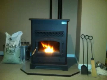

    Going to attach the files from US Stove about the 2 fixes they sent me. I think the attached below. I will also take a phone picture.
    Here is the stove in the basement. The pellets in this pic are the ones from Curtis Lumber.
