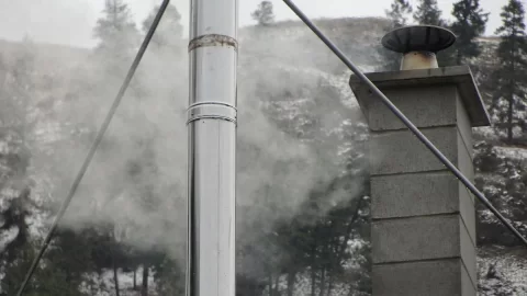

    Got the new BK Chinook installed last Saturday.
    The install:
    New 6" rigid SS liner in a masonry chimney - it's an interior chimney.
    Stove is in the partly finished basement. Stove pipe goes vertically for about 34 " - then 2 45 degree elbows - then a 1 ' piece into an excel insulated thimble - into the ss liner which is 21 feet.
    So far so good: I get 12 hour burns without even trying! Am trying for a 24 hr burn right now - am about 10 hours into it and looks like almost 1/2 the wood is gone. Tsat is at 1.5 and the stovetop is maintaining just under 300.
    The wood: fir and Larch which has been split and stacked for 3 years. Nothing tests more than about 15%.
    Question: I have a thermometer on the stove top - but it's really a convection deck. The actual stove top is 2" below. My readings obviously are from the deck, do does anyone know how to convert from deck temp to st temp? eg. my stove is cruising right now at 300 on the deck - what is the actual stovetop temp?
    Smoke issue: Boy does this baby smoke!! After a reload I go out to look at the chimney and it looks like a steam locomotive spewing smoke! - smells bad too! I'll try to get some pics up for you.
    I used the same chimney setup with another EPA stove for about 5 or 6 fires. It acted just like my other chimney does with my Oslo - a little smoke on reload but none after the secondaries are engaged.
    Even after closing the by pass, it smokes really badly for awhile --then slowly cleans up. Takes about 5 hours before it's clean
    I spoke to the tech at the BK plant in Penticton...good guy and really helpful. I asked how the smoke gets by the combuter and spews out the chimney. He said that all the smoke will be definitely going through the combuster...but if the chimney has excessive draft the smoke will be going so fast that there won't be time for the combuster to "catch" all of it.
    He suggested that I install a key damper to slow down the draft a little. Haven't tried that yet - will likely do that tomorrow.
    Any other BK owners have this problem?
    Also, today - about 4 hours into the burn - I went up on the roof to check out the smoke--only a small amount drifting out by that time. Honestly, it was more like water vapour than smoke. Very little smell to it, and I put my hand into the chimney and it was barely warm. What alarmed me was that the inside if the chimney was quite wet, and also it was dripping down the side of the SS onto the masonry cap. Not really creasote - just a slightly brown liquid! What gives here? Condensation?
    Any input will be appreciated. Sorry for such a long post!
    (got 1 pic up - buts it's probably 1mg!! Something else to figure out!!)

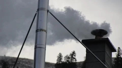

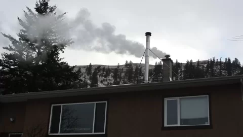

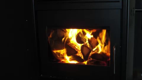

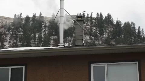

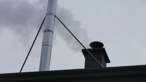

    Posting pics wasn't too hard. Here's some more. The last few are with the bypass closed, roaring fire, stack at 400+ degrees and probe at about 3 o'clock

    Is the liner insulated?
    If not the condensation maybe from the temp diff from the inside the liner and the outside of it..maybe?
    Maybe some of the smoke is water vapor because of the condensation?
    I would think if you are getting 300 on the deck you must be near 500 on the stove top.

    I get a lot of smoke at the beginning too, not for 4-5 hours, maybe 1/2 hour or so, same problem, my draft is super strong, 26 feet, inside chimney, only problem is I have to go knock cresote off the cap about halfway through the burning season, first year it got plugged up and I was getting smoke in the house. Since I have an insert Im not sure how I could slow it down.

    That's alot of smoke. I agree, somethings not right. Wonder if that combustor is good?

    Water pouring off the cap when outside temps are only 32 and with a fire like that? I would be suspicious of wood quality.
    My BK makes a ton of white smoke until the cat is engaged and I throttle down. Never tried to run it for any length of time at a high setting. It gets too dang hot.
    Could it be that EPA testing at low burn rates heavily favors cat stoves?

    True, if those smoke pictures were taken within a minute or so of reloading, then that is pretty normal. Usually, as long as the wood is dry and quickly ignites I will only see about a 1-2 minute puff like that.
