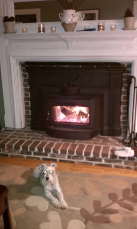

    I've added a picture of the install to this and made it my avatar. The dog loves laying there. Notice my sweet secondary burn.

    It looks perfect!
