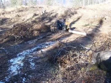

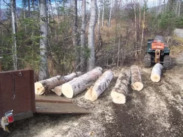

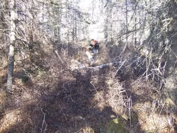

    1 fell & limb tree
    2. mark every 17" & cut into skidable size logs

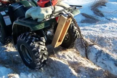

    3. skid logs to trailer with ATV

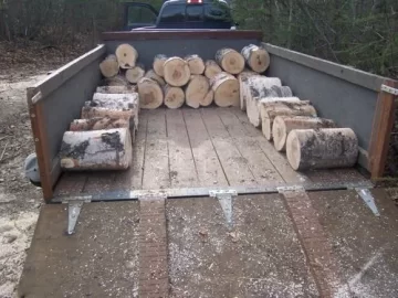

    5. Load rounds in trailer

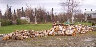

    & off load round to a pile at the splitting area:

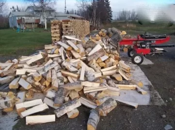

    7. split & throw into a pile near where they'll get stacked for a year

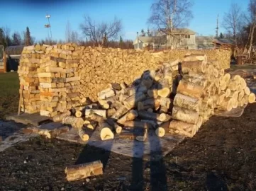

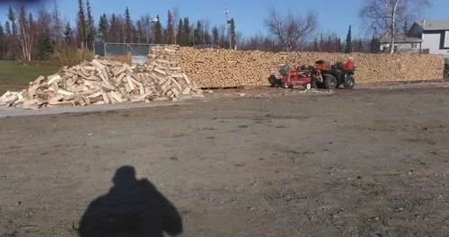

    8: stack in double rows on pallets

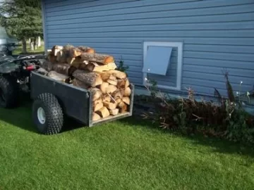

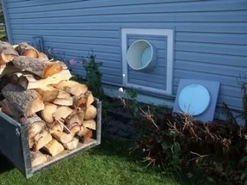

    11: From shed to ATV trailer to the house

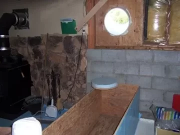

    12. Down the "wood chute" into the wood box in basement

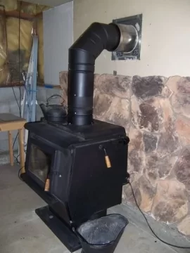

    13. Go to basement & stack in wood box

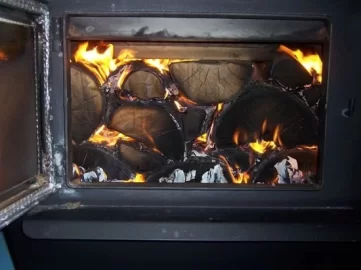

    12 load in stove

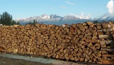

    Particularly like this one with the wood stacked neat and the mountains -
    [​IMG]
    Beautiful.

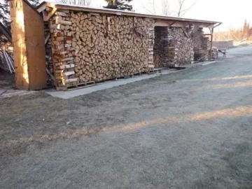

    Is photo #10, the wood shed... is that where Santa lives? or does he still live in North Pole?;lol

    And thats a very packed tight woodstove , Great job dave love the firewood chute.

    You must be a pretty big guy. I have to use ramps, to get 'em into the van,
    and it still darned near kills me!;)
    I wish I could dead lift half that weight.
    Oh- very nice setup, Dave!

    Will try to find pics of the wood chute (shoot). 1/2" wall PVC, 16" diameter with 2" blue board glued to plywood for cover/plugs.
    https://www.hearth.com/talk/threads/new-improved-wood-access-chute.88555/
    You are right about the trailer, I max load it almost every trip.

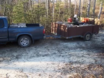

    Been looking for a dual axle trailer, none for the price I want to pay yet.
    The nice thing about the size of this one, 6 hours averge to fell, skid,buck & load it.
    That's a good days work for me.
    Bigger trailer & I'd work way to hard to get a full load ;)
    Thought about adding an axle with brakes to it. Make it a dual axle,. Some day ;)

    I'd have added a couple of steps in between 6,7,8---namely stop, look up and marvel at the view. Awesome work Dave!

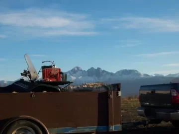

    Dave could you tell me about the yellow rig on the back of your quad?

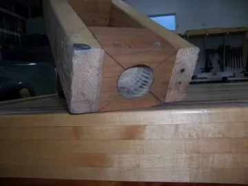

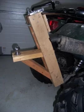

    Made it 1st to skid logs. I tried skidding with the ball hitch but it was low & the front of the logs would get stuck often. Takes most of the stress off the rack.
    Made a brace from the rack to the ball & hooked the logs up higher, as I pull forward it lifts the front of the log, now they rarely get stuck.
    Then I added a 2" hitch ball mid way up to tow the splitter & empty trailers.\
    Down side is there is no rear suspension when it's on, I just drive slow.
    Pull too hard & the front tires come off the ground.
    Clamps to the rack & slips over the ball.
