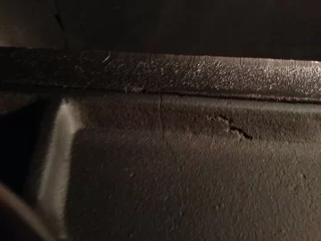

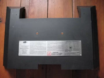

    So I bought a new Defiant 2 in 1 cat stove from my local VC dealer based on a very positive experiace with a 25 year old Defiant that has served me well for 20 years, that now suffers from cracked baffles. Anyway I'm still trying to eliminate some gasket leaks in the new stove, and I see a small crack in the casting that makes up the back of the stove. We're now 2 months after the purchase, and the dealer is out of business after about 75 years, so I contact the nearest VC dealer and they ask for serial number etc. Looking at the rear heat shield supplied with the stove which has the serial number etc, it's not for this stove.... it's for a defiant 1610 non cat. So I now have a (slightly) cracked stove with no serial number. The crack starts at the edge of the back plate, and is about 3/8" long, and is next to a small whole caused by porosity. It may never amount to anything, but it never should have gotten past q/c, and if it propagates any further, the back plate is done. The stove was a floor model, but I don't see that this should make any difference since were not talking about a few paint scratches. So it looks like I have no serial number, no local dealer, and no warranty. I'm usually not the guy that gets burned, pardon the pun, but I think this is going to hurt...

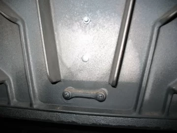

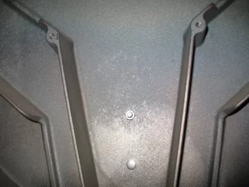

    Thank you all for the suggestions and contact info. I just looked at the back of the stove with the heat shield removed, no s/n tag. Perhaps it was removed

    Post photos of the heat shield and the back of the stove without the heat shield.

    Here's a few photo's of the heat shield, and the stove back. I assume I don't need to install the rear heat shield if the stove is in a large fireplace.

    You're gonna have to help me out. I do not see the crack on the back casting.
    I didn't realize they put the stove plate on the heat shield on the 1610 models. I wonder what the deal is with that. The 1610 was the non-cat model of the Defiant from the previous generation. It makes sense that the new stove would use the same heat shield as the new stoves were based on the non-cat design rather than the cat model.

    Thank you for your help with this. I included the photo of the back of the stove to verify that there is no serial number info once the heat shield is removed. I will have to get a photo of the crack once the stove cools down. (Yes I'm using the stove right now as the crack is not very large, and won't let air in.) I assume I'll have to ship the stove back to VC for repair / replacement.

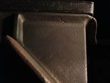

    Here's a couple photo's of the stove back. Best I could do with my phone. I called VC directly, and they referred me to their website so I could find a dealer in my area. I called the dealer again and left a message. So far no reply...

    But, yes, I would be annoyed at that crack. It also looks like the casting has a chunk taken out of it on the right of the crack.

    The 2n1 rear heat shield is standard so that is part of the stove. The serial # on that is your serial #. I am pretty sure the 2N1 was not produced until after MHSC bought them so I don't think you will have a problem with them saying it is not warrantied. When comes to the dealer it the worst time year and they are probably sick of VC already and just keeping them around with dreams of them coming back around. So if you like movies take Dalton's advice from Roadhouse be nice.

    I believe that void is 'as-cast'. The upper right part of this back though is missing a chunk on the lip. Just a poor quality casting. You definitely need to get on them to replace that.

    Smokey , are you sure it is the 2N1 ? A picture of the inside would verify which model. Also would be interested if on the tag if it said CFM or MHSC.
