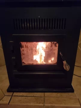

I just bought a new house that has a pellet stove made by Canadian comfort industries. I have the manual but no idea which model I actually have. So far this has been a horrible experience. The auger kept getting clogged and stopping. I disassembled the auger and have it full cleaned out now. I do not like I have my flame dialed in correctly. Does anyone else have a CCI stove? Any tips? I've included a few photos. I am hoping I've fixed the auger . Thank you all and I've enjoyed reading this forum for the last few weeks.

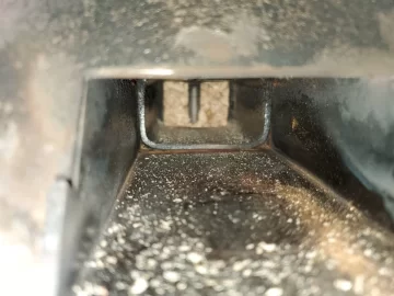

Thank you for your response. I've tried 4 different kinds so far amd always clog at the top of the drop chute. When I clean it I then run it without a fire to make sure it's running well. However it always seems to clog again about every 8 hours. Picture attached is looking up the drop chute to the clog. Any ideas?

You will have to clean it out (the hopper) vacuum all the fines(sawdust). You will probably have to clean your pellets before you load the hopper to keep the fines out. Google pellet cleaner or vacuum.
