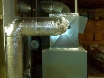

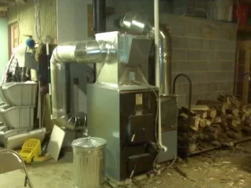

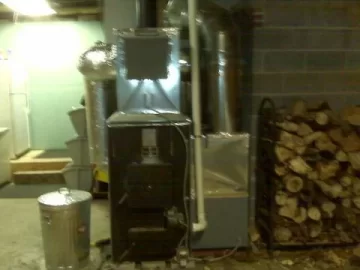

I have tried to post a picture of it here, but for some reason my satellite internet does not like to post pics here.
The kitchen is next to the garage, so return air come out of the kitchen to the stove, then gets sent to basement to be distributed throughout the house by existing heating vents.
The fresh air is PVC pipe that runs from the overhang of the garage through the attic down to in front of the furnace. I took pics, so at work tomorrow I'll post them with the fast internet.
OK, pics were too big, but figured that out.
Just to explain photos, return air from house comes into right side of furnace from kitchen, very short run. Goes through stove to plenum on top of furnace, comes out left and right side of plenum and goes into basement to join the existing piping.
1 side of hot air is insulated, the rest is not but needs to be.
White PVC is only 2 inches, will change that with 4" or 6" soon.

Very nice set up mike,never seen one with fresh air! any way to get a close up of it?
Very nice set up Mike. I am interested in putting a wood add on furnace in my garage. I would have to run my ducting real similar to yours to get to my central furnace plenum. How far does your ducting run once in your basement to get to your existing duct work? Mine would have to run about 20' to get to my central furnace plenum. Don't know if the distribution fan on the wood burner would be able to push the air that far. Do you use your existing furnace fan to help, or just the fan on the wood burner? I see that your hot air ducts go to the wall, did you just run them thru the wood wall? I am thinking of either the hotblast 1557 or the clayton 1600. I've been told that the fans on the 1557 would be to small, so that is why i am considering the 1600

It's about a 20' run from the wood furnace to the end of the ducting of my propane furnace. I connected to the end of the run because the propane furnace is another 45' away, then it's another 30' to the other end of the house. I don't have it set up for the propane furnace to help move the air, in fact they really fight against each other if they are both on. I would of liked to set it up to have the propane furnace help with distribution, it was just impractical in my situation. I have the biggest furnace fan that Yukon sold, and it keeps the whole house warm. It does not move air like the propane fan, there is less pressure, but it keeps the house warm all over. I could put 2 fans in, one on each side of the furnace, and I still may do that someday, I think I would make it more efficient. I went through the sill of the house to get to the ducting in the basement. I did it in a place where it is safe (the builder is a friend, he and I discussed where I could put it and not cause any problems. I just cut out the end caps, not supporting timber).
