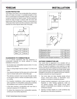

1) The flooring in the house is stained and sealed concrete. Will this mean a hearth is not necessary? The instruction manual for the stove says that “This heater must have a non-combustible floor protector with an R-Value of at least 1.2 installed beneath it if the floor is constructed of combustible material.”
Being that it is just concrete is it necessary to use a floor protector?
2) From the attached image it shows that since the stove will be facing angled / caddy cornered, I will need 18” of clearance from the wall to the back of stove. Would textured drywall over wood studs be okay to leave behind the stove, or do I need to plan to do cement board and tile? If I am say 20” from the wall to the corner would I be okay to just leave the wall bare?
