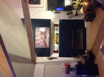

    So here is he problem and my question of which one should I install, a Fireplace stove insert or a free standing stove. The house is 2100 sq feet, is on stilt and is two stories. It is an "upside down" house, that is, the bedrooms are on the first floor, and the 2nd floor is one big great room containing the kitchen, living room and family room (TV) area, but all in an open cathedral ceiling great room(about 1400 sq feet). This is where my existing fireplace is, and this is where I will install the new unit. My goal for the unit is to continue to enjoy the fire, but also heat the house, or at least the great room most of the time. The master bedroom (the only bedroom used) is directly below the fireplace.
    So do I install a Fireplace insert, and use a forced air blower off the back to blow heat down into the bedroom below to help heat the 1st floor (or bedroom anyway), OR do I go with my "dream" of having a free standing unit, but no blower to heat the bedroom???

    So many questions,...... HELP!!!!! What would you do, and why??? Picture of the space attached.

    Whenever reasonable, I choose the freestander over the insert. In a good many cases, a pre-fab fireplace is not allowed to accept an install of an actual insert. So if that has to come out anyway, then you might as well have a freestander, with a blower (best of both worlds).
    If the power goes out, you'll still get good heat from the freestander, and as you mentioned, still be able to cook on it. If the power goes out with the insert, you can cook inside if (if you have cast iron pans) but you won't get nearly as much heat off the unit.

    Free standing is always the best if you think it will/maybe used for emergency heat. Inserts and ZC EPA fireplaces need electricity to get the heat out of them. They are probably a wash efficiency wise.. again, as long as you have power.
    Cooking IN a wood stove doesn't happen much (unless it's a cookstove), but many do cook on top. With only 1000sqft or so to heat, you will need a smallish firebox to keep from either cooking yourself out, or, burning the stove to low on a daily basis. Under 2cuft I would say. The downside of a stove that small is they have to be fed more often.
    Either way, I am guessing you will need to do a complete tearout of your existing chimney, and replace with class A. If that fireplace you have now is like mine was(and that is how it looks...)
