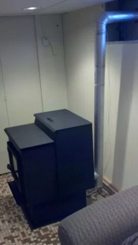

    Hi Everyone,
    Im new to this site and new to the world of pellet stoves. I just had a Heatilator PS50 installed on Friday 12/9/11. Looks great, nice flame like a stove but im not sure if im running it right or what i can do to make it better. First, i have tried 3 different pellets... New england, Instant heat and LG. I have the stove downstairs in my semifinished basement and when you are down there it is piping hot, but to get it to be warm upstairs i need to set everything on max and that is only with 30 degree nights. If it is only keeping up now im in trouble on single digit nights.
    What i have done
    Installed a vent almost above it which is in the livving room
    Installed a vent about 6-7 feet to the right of it which is in the kitchen
    Installed a vent about 20 feet away which is in the hallway
    Placed a fan about 12-13 feet away to blow on the right side of the fan to start a circulation effect.
    In the daytime its good, im at 69 degrees right now with it on Med and the thermo is set at 90, but 69 upstairs
    I opened the fuel adjustment rod to pretty much all the way as the flame was only about 2 inches tall. Noticed this gives a little more heat out of the blower but not to much for all around warmth in the house.
    My house is 1364 CuFt upstairs and 600 downstairs. I have an open stairway to the downstairs so i dont need to worry about a door or hallway to the downstairs. All in all i thought i would have to keep the stove turnd down so as not to be cooked out of the house but im at the complete other spectrum. I have the oil heat we used completely off since it was installed on Friday so i know the stove is doing a good job on the house. I just would like it to be a bit better.
    Can anyone give me pointers or help on if im messing something up or what else i can do. Im a complete newb to this and i know it will take trial and error.
    All it seems at night when i leave the stove alone and just make sure its full the temp drops 7 degrees or so and getting up in the morning is not pleasant.
    I dont know if i missed anything such as a damper ( dont even know if this has one) or anything else, bur please ask me and ill see if i can get the answer. Any help would be greatly appreciated
    Here it is installed
    PS: just for more info i am currently at 2 or so bags a day and have just burnt the first 2 bags of LG's
    Thanks Jeff

    that basement is going to absorb alot of heat. Check your insulation in your attic....sounds dumb to say this but all that warm air rises... Air sealing and insulation fixes that. That house isn't that big.

    Two things you have to produce enough BTU's to over come the heat loss of the area you are heating and then get the heat distributed after producing it.
    Producing it usually isn't a problem keeping the houses heat loss down and distributing the produced heat can be a major headache.
    First lets see what the whole house sort of looks like I'm assuming that the cubic feet you posted is actually square feet so you have the stove in a basement room is the basement fully finished and all walls insulated and if they are insulated with what and how thick.
    Second can we see a picture looking up the stairs from the basement and down the stairs from the first floor?
    Frequently there is an air block that sets up in most stairways.
    Third where in relation to the door out of the room is the stove's convection air system pointing.

    Jeff, a little more info is in order here.
    Your house has some other form of central heat right? What type and how many BTUs did you use through that before adding the pellet stove.
    This is important because it tells you and us how much heat you actually need to keep the house comfortable.

    Smoke show, the pipe exiting the basement window is a duravent. One of them says 3pvp-36. I measured it and it looks to be 3.5 inches.
    Smokey,
    The house is from the 50s. HOnestly not sure what is insulated downstairs. I can tell you that it has a drop ceiling with insulation between the rafters downstairs. The downstairs is pretty much fully open until you have to round a corner to get to the laundry room. The stove is blowing straight at our garage door. I will upload pics. i have quite a few and the should give you a good layout. I dont know if the walls a re insulated since it was finished before we bought it. It is hot down there once it is going. The insu on the drop ceiling is the pink fiberglass stuff and roughly 5-6 inches thick. I was thinking of removing this...?
    Phil,
    Yea thats my next move as well
    I will post the pics in a few minuts

    The cold air can't get down the stair well and the warm air ride up over it. It takes two air flow paths to distribute heat, in a hot air system (which a pellet stove is) one is the convection output (hot air) and the other is the convection input (cold air return). With a ducted furnace these two paths are physically separated by the duct work. With a pellet stove they are sort of separated but only by a couple of feet. So what happens is if there is a long path that things have to take the two mix and nothing really moves between the floors.
    Most stairways are not all that tall these days so the hot air doesn't get a chance to continue rising. It takes a lot of heat and air flow to force air movement in this situation, pellet stoves frequently need an assist.
    Some folks do the fan routine, some do the fans and additional holes in floors and walls. If anyone goes punching holes in walls and floors they need to pay attention to safety. Fire chases result from doing such modifications, it needs to be done correctly.
    I have a nice tall straight up wall just outside the door to my den where the stove is and there is a half wall at the second floor landing the air flow here is such that you can feel the cool air down low and the warm air coming over the half wall and the warm air also goes up the tall wall to the ceiling.
    The only issue I have is moving enough air through the stove to heat it all. There is a massive amount of air in a multistory house and all attempts to heat a house from a basement are in fact heating a multistory house.
    Now for the OP.
    What is the gross firing rate of your oil system it should be on the makers plate or the burner it is stated in gallons per hour.

    Once the night comes 2 things happen. You loose the solar assist and the outside temp drops, So your heat loss sky rockets. 2 ways to fix it. Over power it with more BTU's or Tighten up the joint.
    How warm is it down by the stove? Betting not to bad!
    I'm thinking the stoves too small to heat all that in the house's present condition. Move it upstairs and at least be warm up there. Pick up a stove or something to warm the basement. Or sell it and add a pellet furnace with ducting to move heat where its needed. The radiant from the furnace will keep the basement somewhat warm. Adding insulation to the basement is optional with the furnace. But a must if you try heating with a stove! Edit: You already have a boiler, SO there is another good option. Add a pellet boiler to that. You can sister it right into it!
    Many people try this stove in the basement thing and think it will heat both area's just fine. Not so, heat loss is tricky. You'll get some upstairs, As the warm air rises it is mixing with the cooler air. So you loose some heat. But as the temps drop the heat loss effect gets larger and the efficiency drops like a stone! Insulating the basement helps but it is still hard when the real cold comes by. So in turn you can make it better, But it doesn't totally go away. Forcing the heat thru a duct is the ticket. Once the ducts warm you don't loose as much heat. Specially when you insulate the duct work. Less area to absorb the nasty cold.
    I speak from many years of experience heating from the basement and tried about everything possible with a pellet stove down there. But as soon as the temps started dropping I always seemed to have trouble. I'd get typing cramps if I typed everything I tried to move more heat upstairs. My latest was the ticket. I made my big beast of a stove the closest I could get to a furnace. I added duct work and a larger blower to move the air thru the duct work. I now have 74ºF temps easily upstairs and mid 60's down stairs. Pellet consumption dropped as well. Wished you would have asked us sooner. I would have definetly pointed at the pellet furnace!

    One major difference between your layout and mine is the shot across to the other area of the basement so you are heating the entire basement. This diverts the amount of heat that can go up the stairs. My stairwell is solid wall with a door in it that leads to the garage and that wall is insulated and double layered.
    So it appears that you are attempting to heat close to 2700 square feet of house, but likely really needs close to 33,000 BTU of output to do that (going by the boiler figures and some weird adjustments for domestic hot water and reasonable temperature recovery rates on cold days). The BTU figure for your stove is an input firing rate (I swear it is on a good day with no head wind using the best possible pellets to boot) so at full bore you are getting about 37,500 (using another dubious efficiency figure).
    You need to stop some of that heat from going across the bottom of your stairwell and get it going up the stairs instead as well as run the stove full out (if it can handle that).
    I hear ya Jay, I hear ya.
    Do you know the convection blowers air flow rate on that stove and what are the ceiling heights in your basement and first floor?
