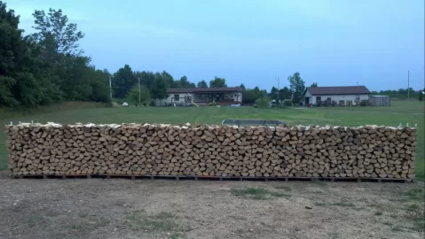

    What type of tree was that? Is that a Big White Oak? Only ask because it will still be wet next year. My Oak is almost 2 yrs old and still has a pretty high moisture content.
    Most wood will season in a year. But Oak takes about 3 yrs (dont believe me. Go tell the guys in the Wood Shed Forum that your gonna burn Oak after 1 year! !!! Better hang on to your seat! ;)) If your gonna burn wood. Its best to get 2-3 years ahead. To always ensure your burning good seasoned wood.
    Thats a nice saw. Is that a 460? I have one. Prob the best Firewood saw on the Market! As far as power to weight.

    Hey Dexter, I know you stack your pellets straight, but I never saw so many wood stacks that you could snap a chalk line on :)

    That fella really likes playin with his wood. ;em Me thinks he needs a hobby! Fishin might work? You can crank your handle and fondle your rod all at the same time! ::-)

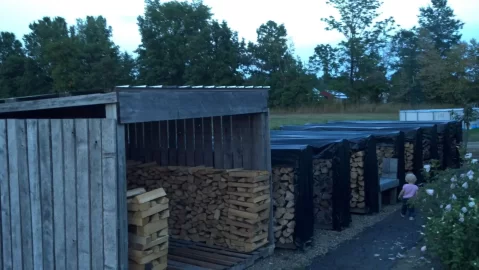

    In that second picture one of the pieces of wood appears to be 18 3/4", you might want to look into that...

    I can picture dexter out there with a gps and laser level making sure that stack is lined up perfectly from every angle Lmao! Sorry Dexter:p back to the regular scheduled program.
