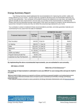

    I finally got the work recomended by the energy audit complete and audited a couple of times. The paperwork is showing before and after. I take the projection with a grain of salt but I really have no way of making a good comparson as I put my storage on line during the same timeframe. The house is a 20 year old modular with a split of Anderson casements and double hung windows. I did finish a large bedroom with 6" walls with 1/2" of isoboard under the sheetrock and also redid one 6" wall with a flash and batt in the cavity with 1/2' iso board on top of the studs.
    Given the numbers I guess I am at the point of diminishing returns. My share was just about $2,000 with the utility paying $2,000.
