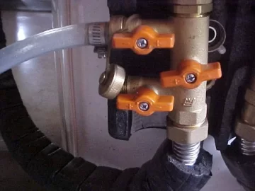

Sediment can plug tubes and pipes also. This was a common problem on the early radiant systems that used non barrier tube. Sometimes it helps to blast them out with pressure from a garden hose, just keep below the pressure relief settings or temporarily remove it.
Same for stubborn air locks, flush with well or city water pressure.
A ball valve with hose bibs on either side is a good way to make a pressure purge port. Or get a pre-assembled on like the ones used on solar installs. This can be installed anywhere in the piping to "power purge" through. Use a clear hose on the discharge to see what flows out and show you when you have a clean purge.
A typical circulator doesn't develop enough pressure to really purge a system, it's job is to just "splash" the fluid through the piping.
Some brands of boiler fill valves have a mechanism to purge at high pressure also, via a bypass lever.
hr
  • [Hearth.com] No Flow on Outdoor Wood Boiler System
