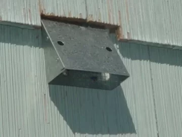

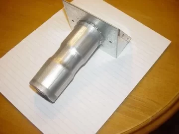

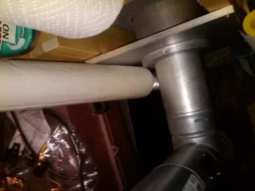

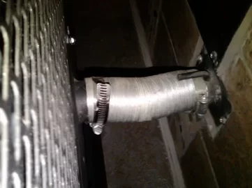

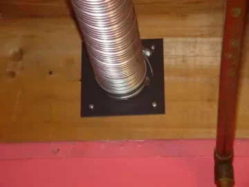

    In my case I could not buy a kit that would fit my install. The best area for my wood pellet stove was in the middle of my basement connected to the center chimney. I had to install a stainless steel chimney right behind it for my oil boiler so it was not easy! So the pellet stove is in the center from left to right and from front to back with vents cut in the floor to bring the heat up. Now the chimney connect was easy but not the OAK. So basically I used a 2" metal preheater hose from AutoZone to an iron wall mount damper purchased from the Stove Shoppe in Windham NH that I mounted in a new tiled wall that I built. Then on the other side of the wall I used a 15 foot 2" flexible metal chimney liner I purchased from fireplace village to go up and over to the back of the house. I then went to midas muffler for a custom 5" long 2" muffler pipe to go thru the wall to the metal hooded and screened vent. Then I covered the 15 foot chimney liner with white Fiberglass Pipe Insulation from Home Depot!
    Most stoves have 2" hole for an OAK which is plenty of air. You can get 3" flexible vent piping and larger from Home Depot.
    Reasons for having an OAK from >> http://used-wood-stoves.com/?p=27446
    We still recommend a fresh air kit for older homes because: (1) control your air flow better, (2) stoves like oxygen-rich outside air versus stale impure inside air, (3) your room air blower is only 12 inches away from you combustion air inlet and it alone could steal (starve) air from the combustion process, (4) other house fans such as bathroom fans, kitchen hood fans, attic fans may starve the stove of combustion air creating a negative pressure; (5) a mechanical pull rod can be used exclusively as an ash dump and not worry about re-adjusting the exact position after each ash dump; (6) ash dropping down should not compete nor interfer with air moving up (because of using a mechanical damper); (7) air should instead come in from the backside of the fire box via using a KIT, not from underneath the fire box; (8) Ash drops may partially clog the opening of the mechanical damper thus changing air/fuel mixture and causing malfunction.
    See Pics below, I used radiator clamps for a nice tight connection. Good luck
    I can stop the cold air coming in with the black lever when the stove is not in use!
