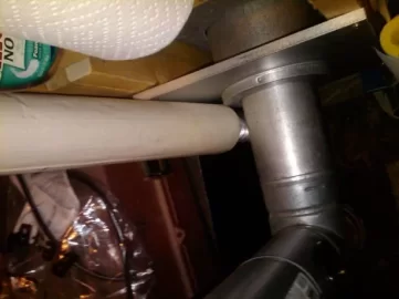

Hello
I have an Avalon Astoria in the middle of the basement connected to the center chimney. The flue is short but I needed a 15 foot 2" aluminum flex hose for the fresh air. I also insulated the 2" flex hose with Home Depot Fiberglass Pipe Insulation and it works great! I usually run the stove on low and the air adjuster on 1 -2 out of 5. Even on higher heat settings I really do not need that much air. So I would say 2" works fine in my situation!
See pic of OAK hose covered with white fiberglass pipe insulation.
