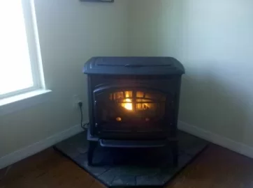

Stove Looks good. Bout time you posted a pic.

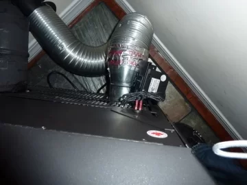

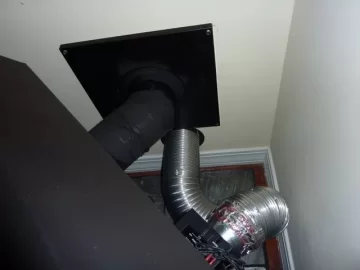

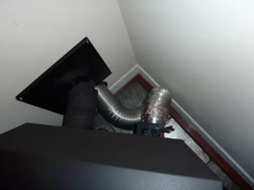

This is what the back looks like.
Vin
sure does look like 4". Should be getting plenty of fresh air.
Looking good, real good, Vin.
Though I am not sure why the installer used 4 inch duct instead of 3 inch. Maybe it will draft better.
The install looks complete, though. You just have to put a wire on the vent hood and a trim on the inside of the OAK duct. Congratulations.
